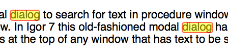

As you type search text into the Find edit box, Igor highlights any instances of the text you have typed so far:
This highlight does not indicate a selection, it just shows you where the search text appears. To select instances, click the green arrows to move the selection forward or backward. The selection highlight appears below the yellow color; here the second instance of "dialog" has been selected:

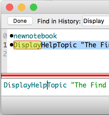

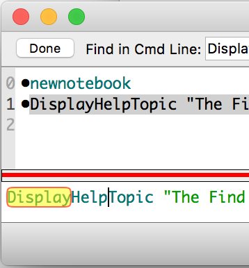

IN THE COMMAND WINDOW
The Command window has a single Find Bar that serves both the command line and the History area. The part of the window that will be searched is determined by keyboard focus. So if you enter search text in the Find Bar and click in the History area, the search will take place in the History. The label on the Find text edit box tells you which part of the window will be searched:

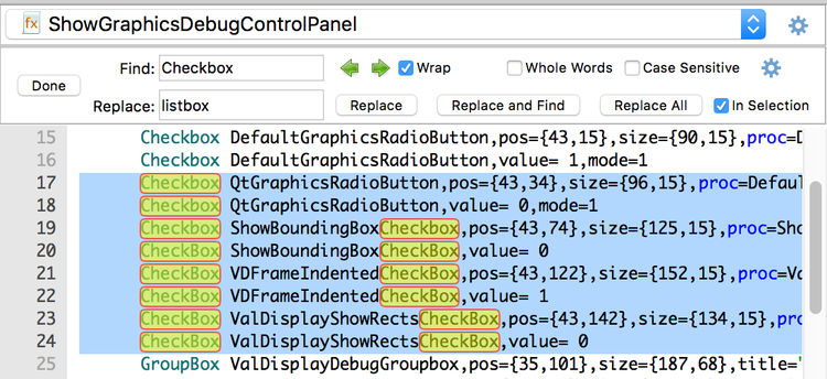

SEARCH AND REPLACE
Select Edit→Replace or type Cmd-R or Ctrl-R to show the Find Bar in search and replace mode. In this mode, you can enter replacement text and then click the Replace button to replace selected text with the replacement, Replace and Find to replace the next instance of the search text and then select the next, or you can Replace All instances. The Replace All can be limited to a subset of your window using the In Selection checkbox. When the Find Bar is in Replace mode, and the In Selection checkbox is on, then the yellow highlight shows you exactly what will be replaced:

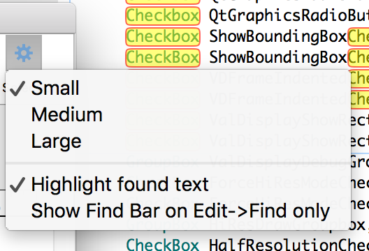

OPTIONS
A menu accessed from the gear icon gives you some control over how the Find Bar works:
The overall size of the Find Bar is changed by the Small, Medium and Large items. The screen shots above were taken in Small mode, but the larger modes are easier to read, at the expense of taking up more room in the text window.
If you don't like the yellow highlight, you can turn it off with the Highlight Found Text item.
If you find it annoying that the Find Bar shows up when you use Find Again or Find Selection, you can tell Igor to display it only when you select Find or use the shortcuts Cmd-F or Ctrl-F.
