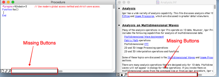

MISSING PROCEDURE, NOTEBOOK, AND HELP BUTTONS
Versions affected: Igor Pro 6 only
Description:
The buttons at the bottom of procedure, notebook, and help windows (eg. Templates, Procedures, and Compile, Find, Search, and Go Back) are missing, as in the example below:
Workaround:
Upgrade to Igor Pro 8.
