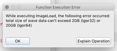

Hello all:
I'd like to load images using the LoadImage command. Additionally I'd like to extract the exif-information from each jpeg image loaded (filter is set, so there are just jpegs).
If I'm loading files using this
ImageLoad /Q /T=jpeg fileToLoad
all files are loaded into the current data folder - like expected
To read exif-tags I added the /RAT Option
ImageLoad /RAT /Q /T=jpeg fileToLoad
If I'm loading a 500kb jpeg Igor gives an error that some wave size exceeded (picture attached).
I'm running Igor 8.02 on MacOS 10.14.2

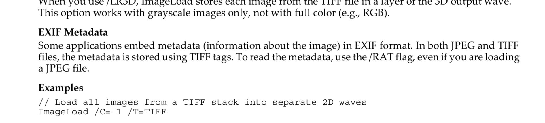

Hey,
thank you for your comment but this is not true - according to the manual. It should work using tiff files as well as jpegs.
I've added a screenshot of the manual for your information - or I'm completely misunderstanding ... might be true, too.
December 28, 2018 at 12:28 pm - Permalink
It is difficult to determine what is going on here. I suggest that you send a copy of the JPEG file and the command that you are using to support@wavemetrics.com.
January 3, 2019 at 01:18 pm - Permalink
