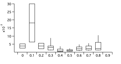

I would like to bin X in 0.1 size bins (from 0 to 1) and represent the Y data (as a box and whisker plot) as a function of each of these size bins. See attached graph (averaged_dataXY).

1. Create a text wave with the labels 0-0.9 in 0.1 increments.
wave Xin,Yin
variable index
For(index=0;index<1;index+=.1)
Extract /O Yin, $("G"+num2str((index)*10)), Xin>index && Xin<(Index+0.1)
I then created a box plot using the now split waves (10 of them) and with GroupLabel as the label wave.

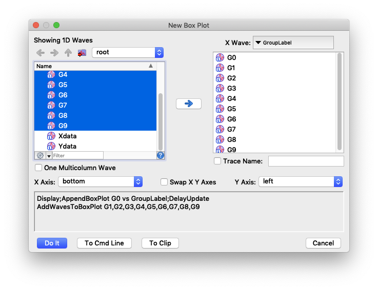

I am using IP 8 and there is a built in box plot functionality. In the dialog box you select the waves which represent each box and the labels.

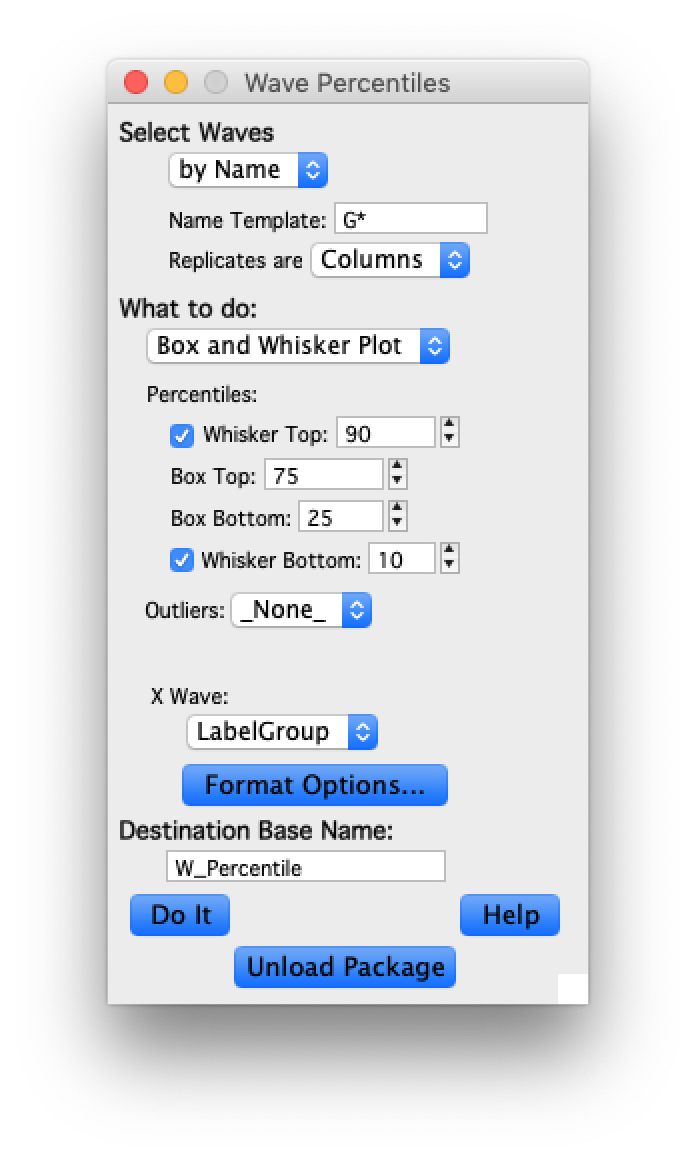

A couple of steps.
first in the procedure window add:
#include <Percentile and Box Plot>
Then I rename Grouplabel to some thing that does not with "G" - you will see why in a moment.
Then under window select Box Plot.
I then select waves by name and Use "G*" to select the split waves -this is why I needed to rename.
Select replicates are "columns" which indicates that each wave is a single group.
And the X label is the renamed wave.

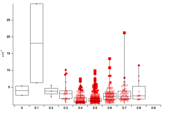

If you need to add the data points, that is a bit more complex.

I just want to thank you for your help. I managed to do the BOX plots in time!! I can try modifying them by adding the data points or having several BOXPLOT in the same plot.. but it is less urgent!!
