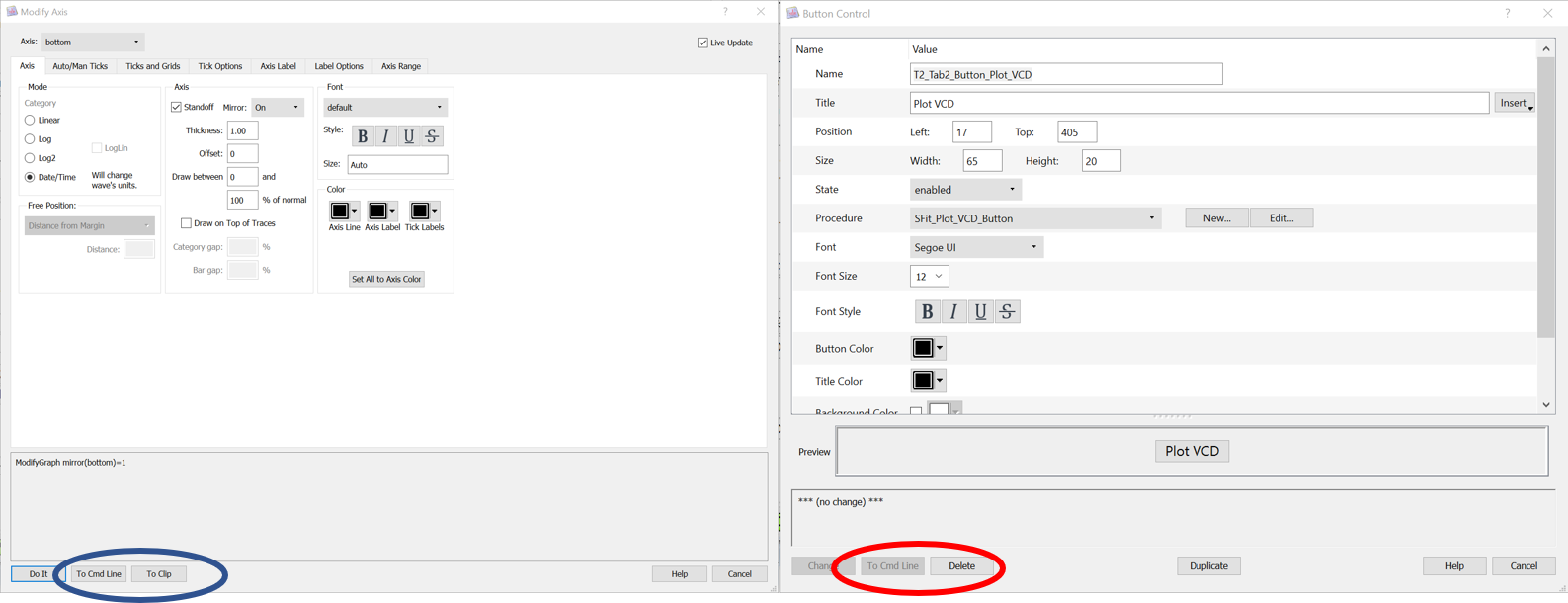

To Clip button on Modify control window
In many of the Modify windows, there is a button titled "To Clip," but this is missing from the windows to modify controls on panels.  It would be nice if this button were present, if only for consistency with the other windows.  Also, it would be nice if pressing Escape closed a Modify control window, which is the behavior of nearly every other Modify (Axis, Trace Appearance, Graph, Columns, etc) window.  Right now pressing escape just reverts to the previous value, which is not what happens in the other windows.
aclight
The To Clip button should be enabled whenever there is a command that has been generated. In your screenshot, you have made no change to any of the properties, so no command is generated and the To Clip button is disabled.
In a panel, if you are in tools mode, you can right click on a control and select Copy Commands to copy all of the commands to generate the control to the clipboard.
As for hitting Escape to close the window, that's something we've tried to do but it's basically impractical to implement in that dialog. When certain widgets in the dialog are selected hitting Esc does close the dialog, but when the property editors are active then the Escape key press goes to the editor which reverts the value.
