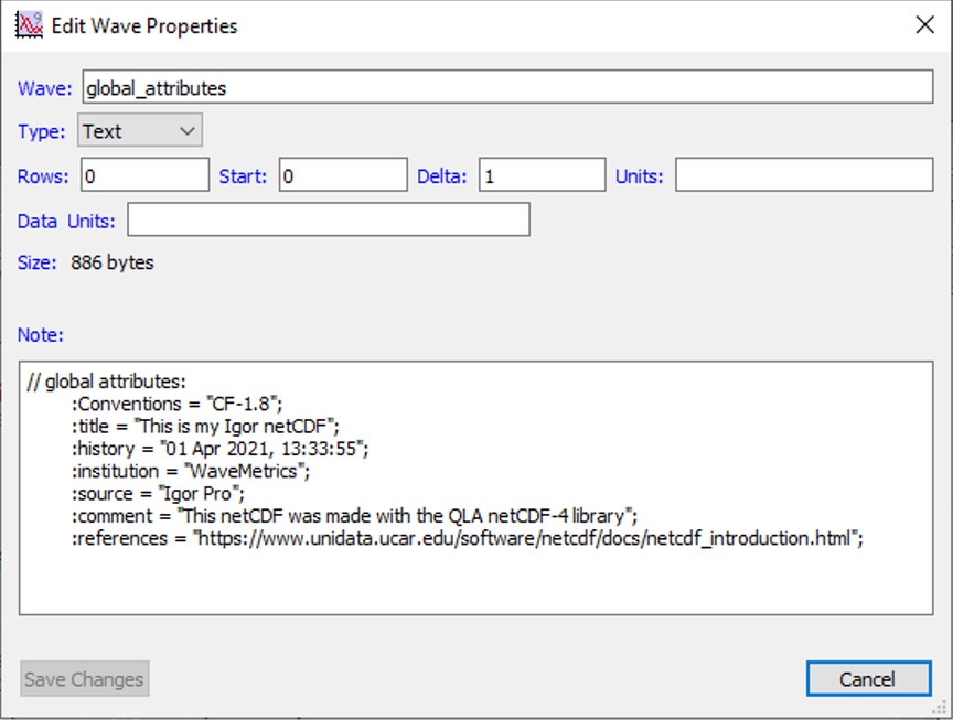

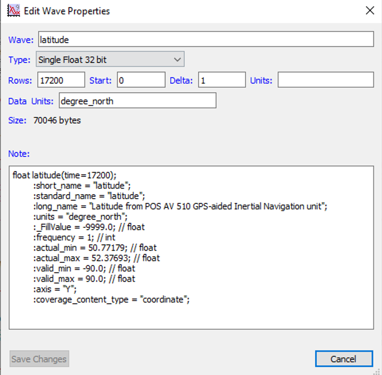

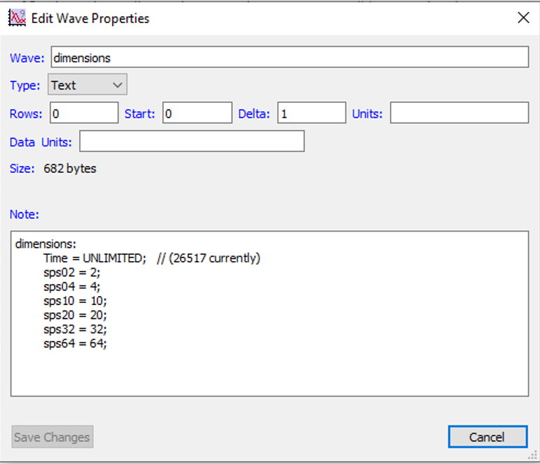

- Parse all netCDF metadata nicely into CDL syntax attached to the WaveNote (c.f. ncdump or Panoply) or text dump
- Set the units and dimension names of the dataset
- Optionally apply scale factor, offset, fill value, valid range to data

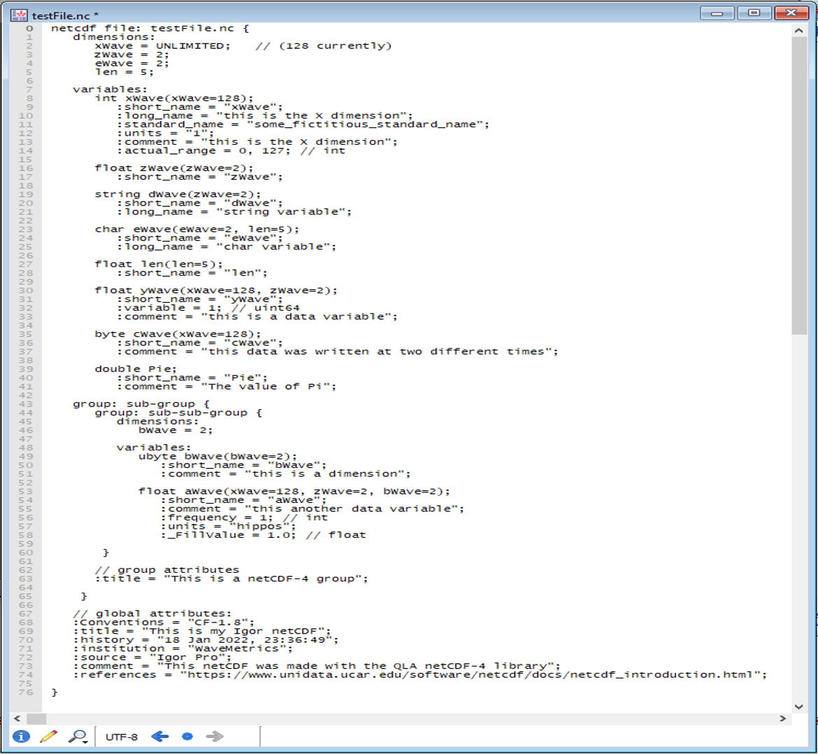

QLA netCDF4 library
- Functions to create netCDF-4 or netCDF-4 'classic model' files directly from Igor
- Switch between types easily without changing any code
- Keeps track of dimension information
- Keeps track of _Netcdf4Dimid and _Netcdf4Coordinates required hidden attributes
- Keeps track of unlimited dimensions, layout, and chunking
- Keeps track of the hierarchy, duplicate names, dimensions size matching etc.
- Provides some basic help for keeping CF compliance
- Provides some hopefully helpful error/information messages in the history area
- Compression and shuffling is available
- Functions follow similar syntax to netCDF C library functions
- Functions vaguely named after netCDF functions e.g. NC_def_var becomes QLA_def_var
A sample .ipf is included which uses almost all the functions available that you can use to make your own netCDF-4 / netCDF-4 classic and figure out how it all works, test the files using ncdump, nccopy, or the included loader etc.
