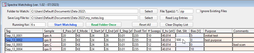

After installing the package two new options appear under the menu entry Spectra Tools: Folder Watchdog and Folder Quick-log; the latter will be explained later. After selecting Folder Watchdog the user interface appears:
First, there are a few things to set up:
- Folder to Watch: Specify the folder to be watched for new data files or to read data from.
- Save Log File to: Specify where the log is written to. This file can be saved anywhere you have write permission.
- Press Read Log Entries if you want to read the entries from the specified (existing) log into the table below. This is useful if you continue working with an existing log file.
- File Type(s): Specify the file ending(s) to watch for. You need to provide at least one loading function for the specified file ending (see below). Multiple file types can be specified as a semicolon separated list.
- Set Ignore Existing Files: This will ignore all currently available files in the folder and only checks for newly added files.
Now you can press either:
- Start Watchdog: The program logs all currently available files with the correct ending and then keeps watching for new files. If you want to stop the process, press Stop Watchdog.
- Read Folder Once: The program just logs all currently available files.
The remaining buttons are:
- Reset All: Clears the table and resets the list of already processed files in the folder. Use this to start anew. You might want to specify a new log as well. If you don't specify a new log file, then files already logged in the file will not be reprocessed, since you cannot have the same data entry in the log twice.
- Clear Display List: Clears all entries in the table below (NOT in the log file). Use this if the table got very long and you want to concentrate only on new entries.

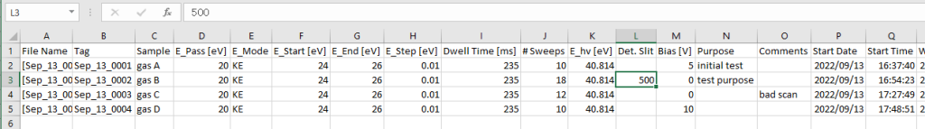

Here is how above log file looks in Excel:
CAUTION: Do not open the log file in Excel (or any other program that locks write access to the file) at the same time while you are still working with it in the Watchdog. Igor cannot update the log in that case.
Working with the Table
Logged entries can be directly edited in the table. Simply click a cell to edit it's contents. Editing any cell with also update the log file on the fly. In other words, the contents of the log and the table are synced. The cell in the first column is highlighted for each selected row. The first column is meant to serve as a data tag for identifying the data entry.

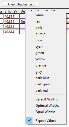

Column options:
In the same, right-click menu of the cell header are additional options:
Widths:
- Default: The default width of the package (optimized for the included file logger).
- Optimal: Tries to adjust the columns to allow for optimal spacing depending on the current contents in each column.
- Equal: All widths will be the same.
Repeat Values option:
If a new entry is written, the content of the previous entry will be prefilled for this column. Use this setting for columns which contain mostly the same information which you do not want to insert repeatedly.
