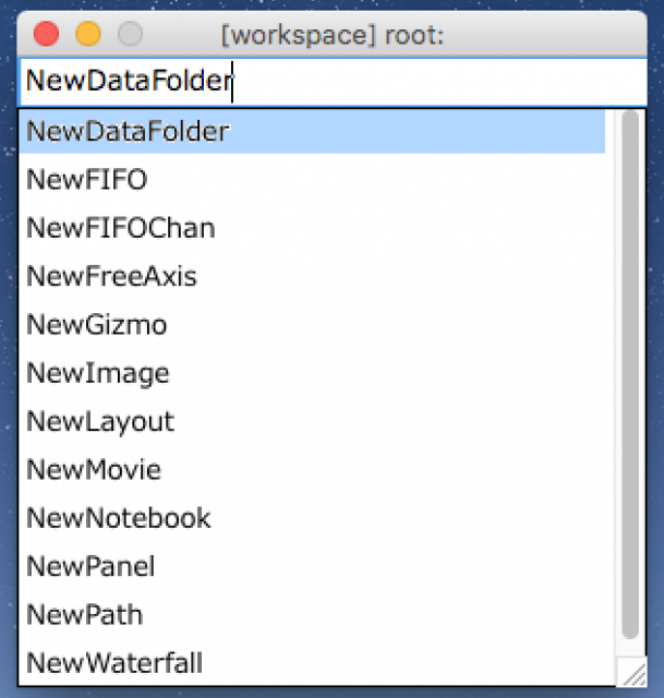

Completion
Your input is completed by pushing Shift+Enter.
This procedure complete operation and function name. Words beginning with : are completed as pathnames.
When you push Shift+Enter without input, the output or complete candidates are scrolled down. (You can scroll up with Alt+Enter in Mac.)
