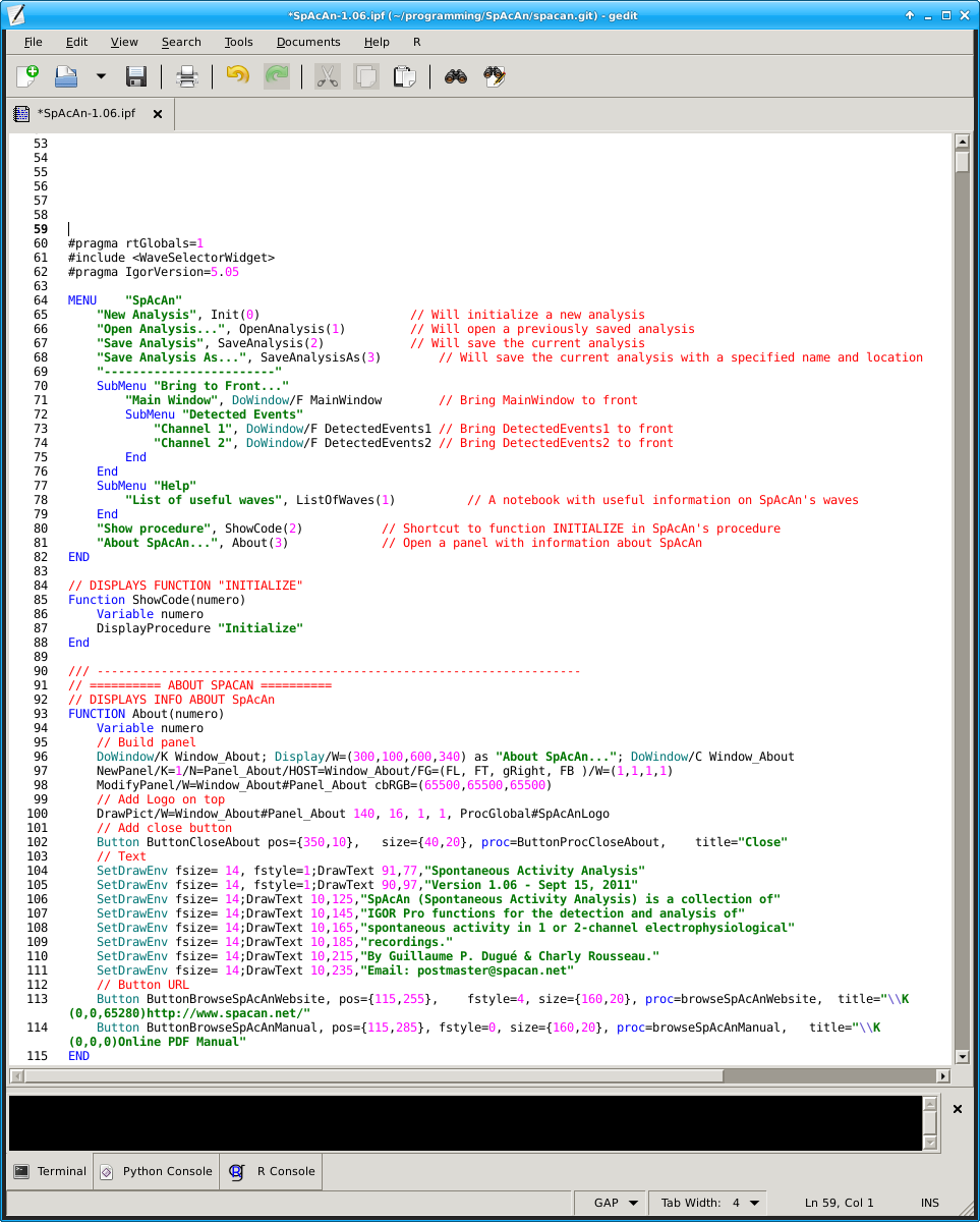

syntax highlighting for gtksourceview for editors like gedit or meld
This set of files allows you to get syntax highlighting in gedit (http://en.wikipedia.org/wiki/Gedit) or meld (http://en.wikipedia.org/wiki/Meld_%28software%29). These editors are crossplatform (windows, mac, linux) and open source.
This allows to compensate for some missing features of the native igor editor, namely:
On mac, this file is inside the gedit app folder when you download gedit
On linux, this file should be in /usr/share/gtksourceview-2.0/language-specs/ (or gtksourceview-3.0 depending on the version of the system)
(the file is called gap.lang since at the time it was created, there was no obvious way to support a new language so the hack consisted of replacing an existing one).
The igor.xml file only serves to get the same colors as in the igor editor. It goes in the styles folder under the gtksourceview folder (you can also load it manually in the preferences menu).
Gedit should now open .ipf files with the proper highlighting. To use the functionalities described above, you will need to activate the corresponding plugins in the preferences. In linux, this requires the gedit-plugins package. On mac, they are part of the package.
It's now complete thansk to Adam Lights Geshi highlighting plugin.
- autocompletion
- line numbering
- automated bracket completion
- automatic indentation
- bookmarks
- code snippets
- Line wraping when printing
- case change
- multiedit (allowing to do a whole column of setDimLabel at once for example)
- and last but not least, side-by-side code comparison.
