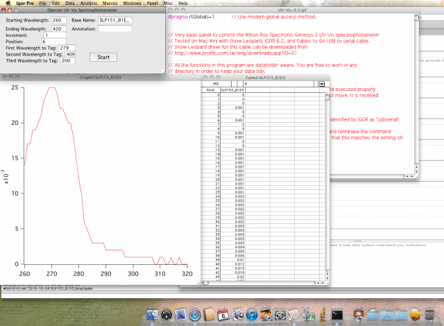

This is a very simple program to get parameters from the user for a UV-Vis absorption spectrum, and then drive the Milton-Roy Spectronic Genesys 2 UV-Vis spectrophotemeter to acquire the data and display it in real time.
The procedure is very basic, but it works. Please let me know of any bugs or mistakes.
The IGOR procedure file should contain adequate commenting. The procedure makes use of the VDT2 IGOR XOP (external operations). So, make sure that the appropriate XOP and help files are linked in your "IGOR Extensions" folder.
