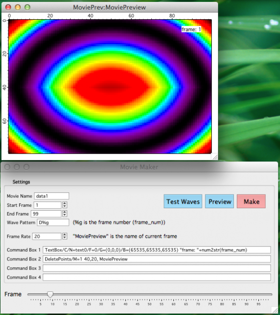

A small procedure that allows you to make movies out of a set of 2D waves.
How to use:
1- Drag drop the procedure file onto igor and compile
2- Run "Load Panel" from the MovieMaker menu
3- Click on Test Waves to make some test waves to play with
4- Click on Preview. Make adjustments, add annotations etc. add extra commands (if any) in command boxes to run on frames.
5- Run through frames using the slider
6- Click on "Make" to export the video
notes: all the adjustments are saved inside the "MovieMaker" folder. This means that if you save the experiment, your adjustments to the preview frame will not be lost.
