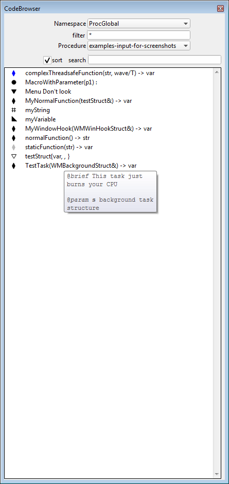

- Shows all functions/macros from a procedure file including parameter types, return types and special properties like static and threadsafe.
 - Shows Menu/Constant/StrConstant/Structure entries.
 - Shows the structure name for window hook and background tasks for easier searching.
 - Allows jumping to the definition of these elements within the code by mouse and keyboard.
 - Optionally alphabetically sorted lists.
 - Shows function comments as tooltips (IP8 only).
 - Works with Independent Modules.
For reasons of ease-of-use the function declarations are displayed as myFunction(var, str) -> var for a function taking a variable and string parameter and returning a variable. Programmers might recognize this as being inspired by the trailing return types from C++11.
