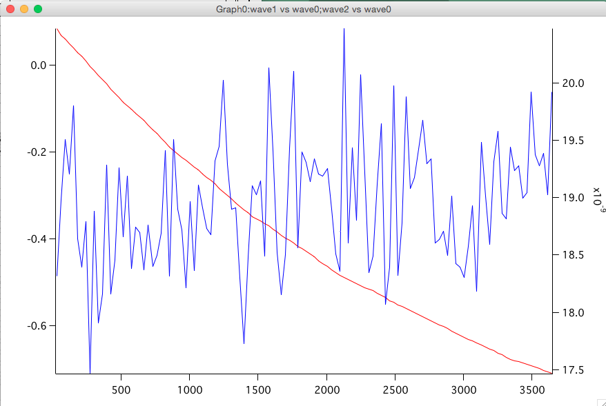

I'm sorry, John, but I had focused on the edit text igor and I forgot to continue the post.
So, the problem is not due to an error that is to compile, because everything is working without error.
The problem is due to the fact that I may have made some mistakes in the PSD.
(I state that I am making acquisitions with national card and an AFM.)
sw creates a series of waves, of which the major that I need are deflection vs. time and variance vs time.
The curve deflection vs. time does not present problems, for the variance vs time curve instead, there are problems.
I expect that the curve should be very steady, without peaks or drift I assure you that is not due to electronic noise as the AFM is isolated and placed in a Faraday cage.
Some illustrative sample data would be very helpful.
In the mean time: Are all cables and connectors OK? Does the "artifact" arise from cross talk between the channels?

This is an example of an acquisition:
experiment time: 3600s
duration: 30s
recording time: 30 seconds
saved rate: 200 Hz
plot resolution: 2
rate: 10000 hz
- Red = deflection vs. time (the correct curve because there is a thermal drift of the tip, and it is normal that it is negative)
- In blue = variance vs time that should not be so
all cables and connectors are OK, and I'm also acquiring from only one channel
What is wrong with it?
Your signal is in the order of 1e0 = 1.
Your variance is around 10e-9 and 8 orders of magnitude smaller. (I would consider this as smooth.)
Maybe you want similar axis ranges for both traces for checking
SetAxis left 0,1
SetAxis right 0,1
HJ
so do you think there's nothing wrong?
So why you see all those peaks? especially at different heights, and also there is a certain periodicity .....

I don't know your experiment and you are generally not providing much information. All I can tell you is that your variance is 8 orders of magnitude smaller than your signal. If you expect it to be 6 orders of magnitude smaller I would say this is good. If you expect it to be 20 orders smaller I would say it's very bad. (Just random numbers for illustration!)
The right axis range should not be smaller than your expected variance. Maybe add some waves to the graph indicating this limit. Otherwise the autoscale feature might make you think that there are peaks but in fact it's just low level noise.
