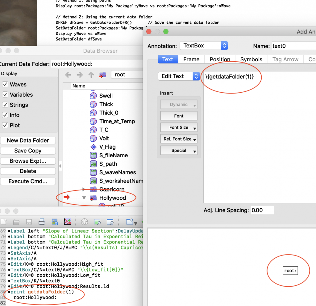

I have a simple interface that let's me switch between directories of data and replete using Replacewave allincdf and then do some refitting.  That works all well and good.  Now adding some annotations to include specific information including some of the curve fit data.
The working folder is root:hollywood: and within it is a wave called Low_Fit
if I do the following
\{low_fit[0]} to try to get the first value it does not work
I have to give the full path
\{root:hollywood:low_fit[0]}  First is this the intended method to require the full path declaration?
Second to get around that since I can't hardcode the path directory, I am trying to use getdatafolder(1) to return the current path.  I get a different result from the command window as compared to the annotation box. Is this expected behavior and if so how do I get the correct path format for within the annotation box?
hegedus
Conversing with WM, apparently the dynamic text construction uses the root directory even if you have a different working directory. A bit of a pain.  My workaround was to create a function that builds up the text and then changes the textbox with the /C flag.
Does the job though I think the textbox should respect the working data folder.

You have no idea when the dynamic text is going to be evaluated. It might be when you first create the annotation, but it might be later on when the graph needs to re-draw because you added a trace, or a wave's contents changed. Or you might export the graph and it needs to be redrawn then. The current data folder could change at any point, and so the only way for you to get consistent behavior is for the dynamic text to be evaluated from the root data folder.

The current data folder when dynamic text is evaluated is *always* root.
Other ideas for getting what you are asking for are:
1. Use a tag annotation that is attached to one of the waves on the graph. Then set the text of the tag to something like:
\{GetWavesDataFolder(TagWaveRef(), 1)}
The problem with this approach is that the location of the annotation will be relative to the point in the wave that you attach it to, not relative to the plot area or graph window.
2. Instead of an annotation, add a user-defined shape to the drawing layer (see DrawUserShape). Igor calls your function do draw a user-defined shape, and one of the parameters in the structure is the name of the window containing the shape. From there you can get a reference to a wave on the graph and find the wave's data folder.
