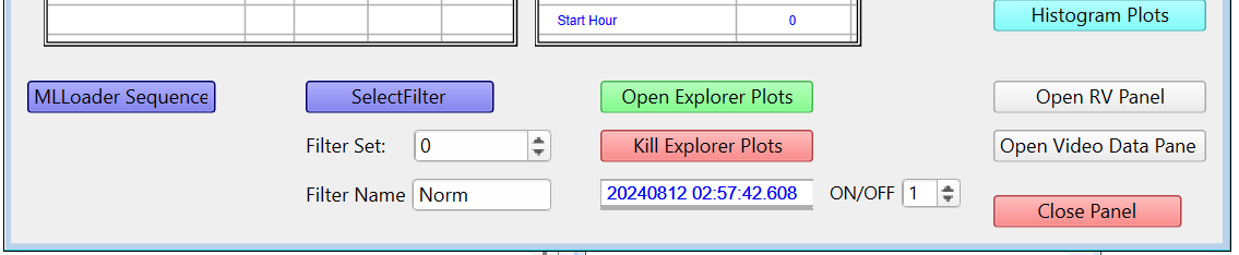

Hallo eveyone,
The top line is to call up a graph macro or function and using a selected date-time from a 20k wave from a table to set the bottom axis range.  The date time format used is, for example 20240812 02:57:42.608.    To select the data requires the date time wave and many other paarmeters to be scrolled and the date time point from the table to be copied  by selection with mouse.
What I have arrived at is to use a single point wave in a panel embedded table and pasting the item into it.
	// Insert table for edit/pasting date time for plot control
	string editTable1 ="root:PlotControl:editDateTime"
	Edit/W=(360,510,490,530)/HOST=Panel_loadUtility $editTable1
	ModifyTable frameStyle=0,format(Point)=1, width(point)=500
	modifyTable size=11,alignment($editTable1)=0, width($editTable1)=200
	modifyTable showparts=0, rgb= (0,0,63000), entrymode = 1, format =8
	modifyTable showFracSeconds=1, viewSelection
 With showparts = 0 as above the embedded table shows the date-time value at point 0 and values can be pasted and copied as expected.  The date-time can be usd by a graph macro with just a few clicks in the panel.  The layout is shown in the first panel snippet below.

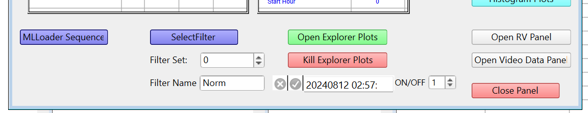

	Edit/W=(340,510,500,530)/HOST=Panel_loadUtility $editTable1
	modifyTable showparts=1, rgb= (0,0,63000), entrymode = 1, format =8
With showparts = 1  above the embedded table shows the edit cell of the table. See second snippet.
How is the table edit cell controlled and formatted to look like the showparts = 0.  i.e. font size and single box?
With showparts = 0 With showparts = 1
