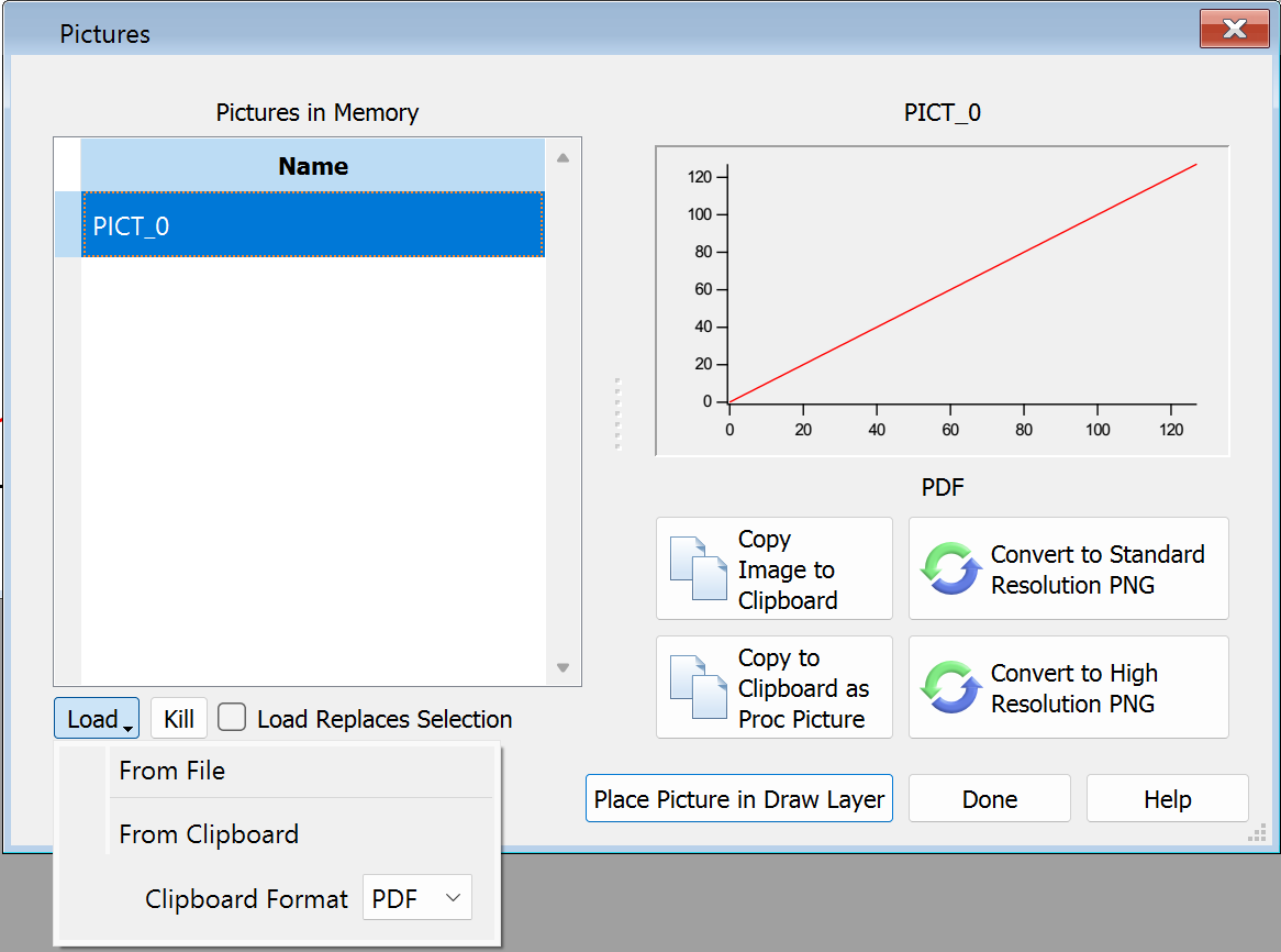

With Igor 9 / Windows, the dialog works the same way: it both puts an image in the clipboard and the format becomes the default action on Edit->Copy for a window.
You can verify this by choosing Edit->Export Graphics when a graph is top-most, setting the PDF format, and clicking Okay.
Then use Misc->Pictures and click the Load button's dropdown menu to show the format(s) on the clipboard, one of which will be PDF:
August 2, 2023 at 10:24 am - Permalink
