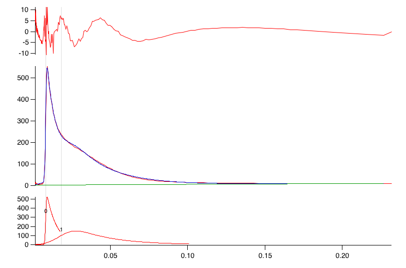

At any rate, I used two exponentially-modifed Gaussian peaks to fit your data. I have added a picture of the result to this post.
I should also note that I fitted a somewhat restricted portion of your data; I don't think that's important. I also used a linear background function. A constant background worked very nearly identically.
