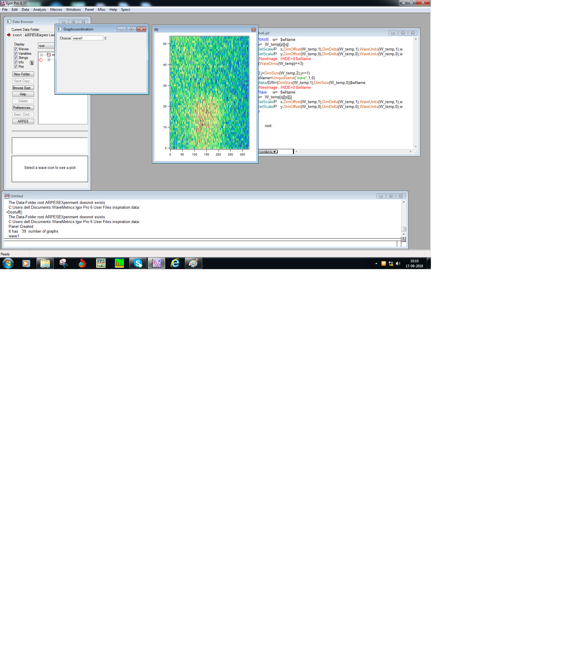

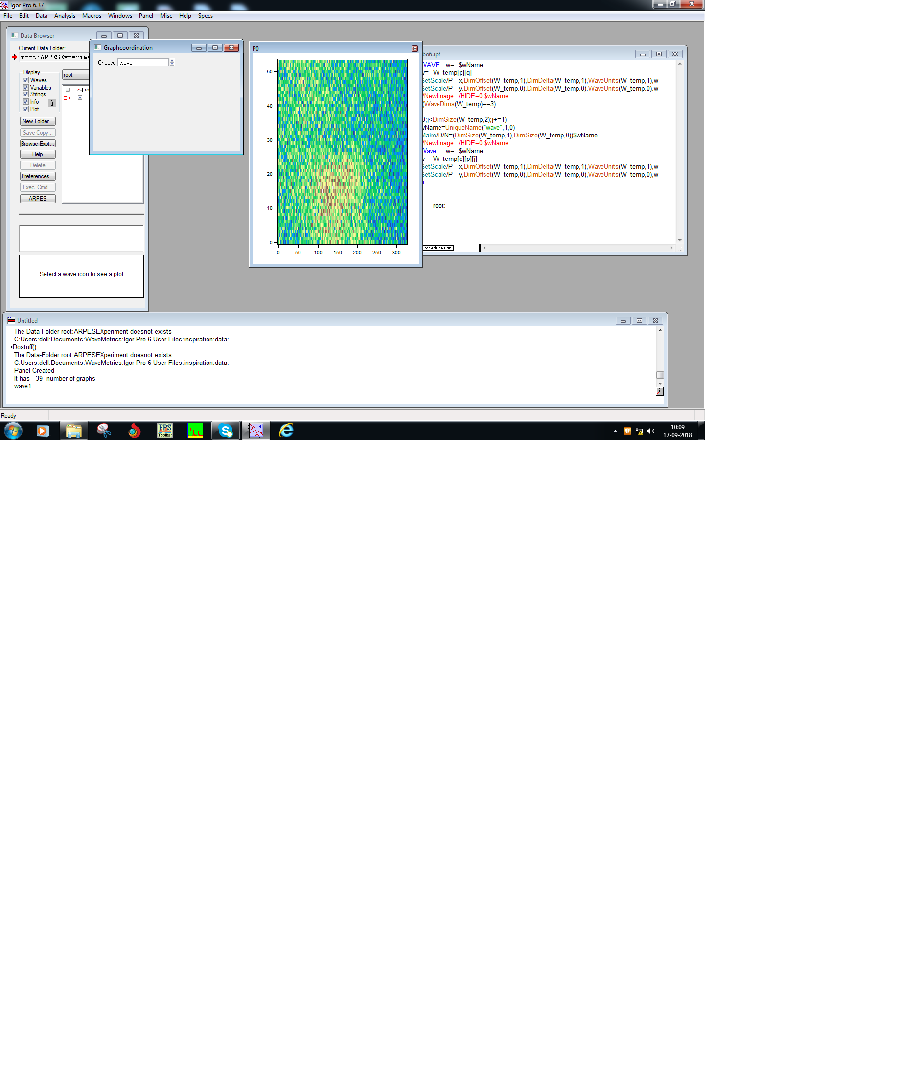

Well, I created the procedure to accomplish the task thanks to Kurt but the issue that I am facing right now with the code is that the code create a panel and a host panel for the preview but when I click on the host window and then directly click on the "setvariable" up and down scroll button it yields to the action desired but it previews only wave 0 while the wave output should change to WAve10 or some other wave number.
 I am attaching the code

Can you create a minimal, self-contained example that illustrates the problem. Posting a large amount of code, that includes a lot of irrelevant code, is unhelpful to those who would try to help you.
I have often found that the exercise in creating such a minimal example enables me to solve the issue as it removes clutter as allows one to focus on the core issue.

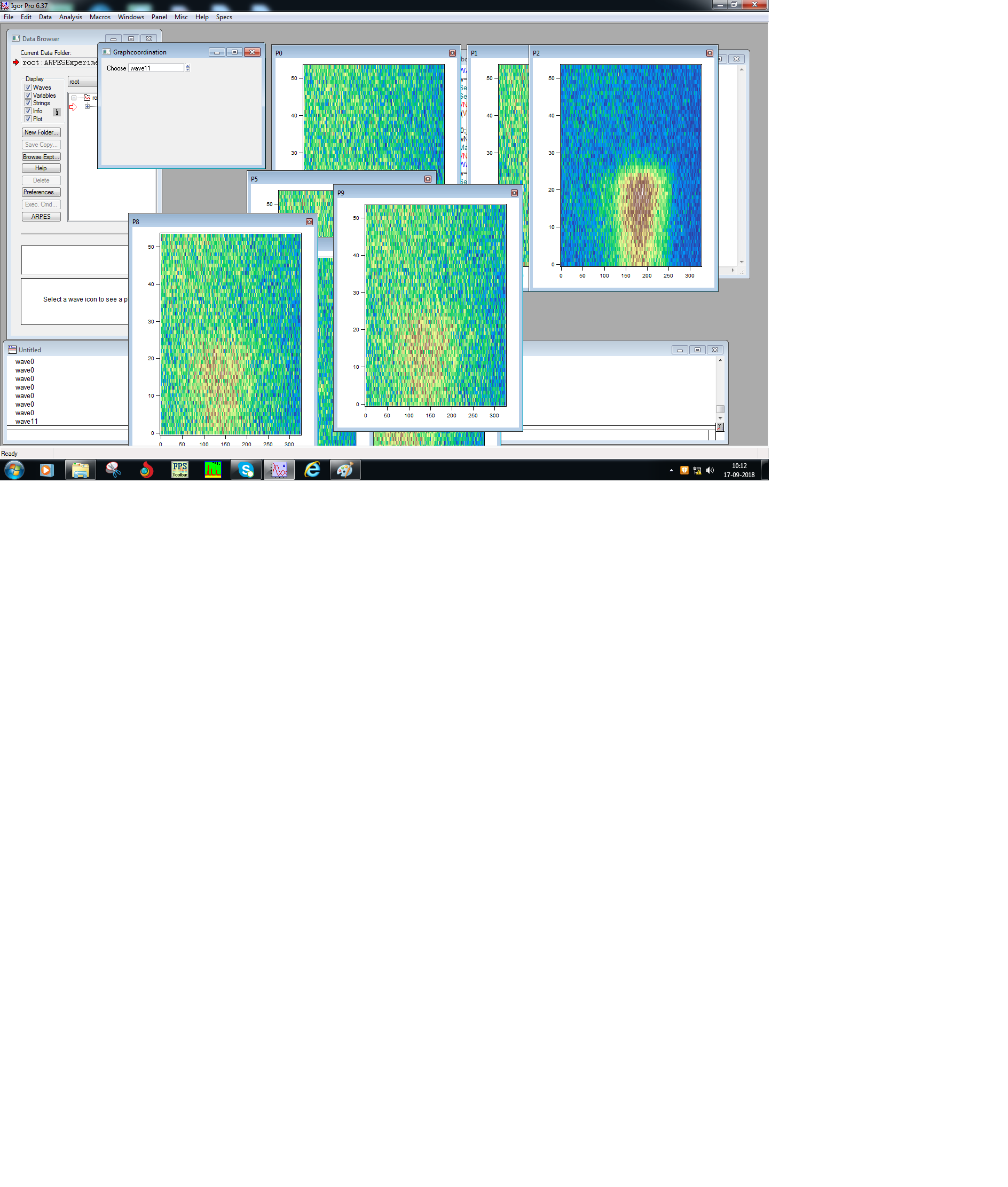

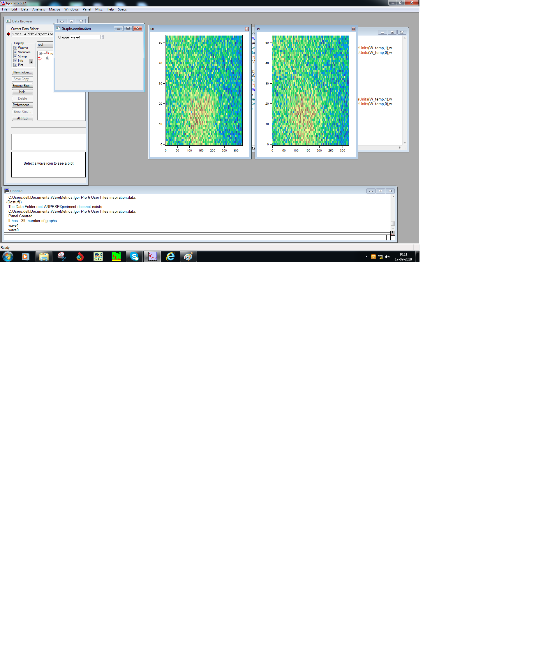

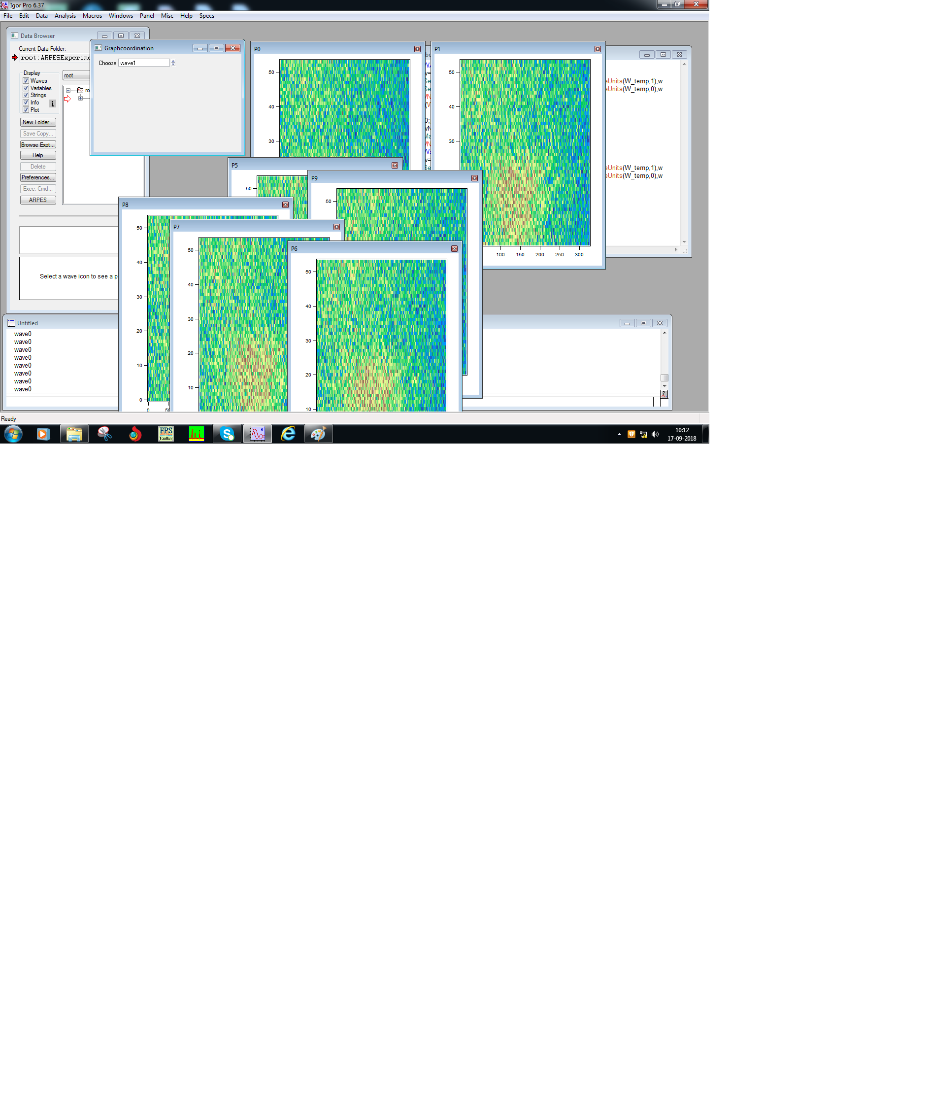

Let us say i click on the scroll button of the set variable for  the first time it should display me Wave0
then let us say in order to analyze the image i clicked on the hosted panel
now I click on the scroll button again it should have shown me the Wave1 in the new panel hosted corresponding to the control panel but i still get the Wave0
then let us say i again click on the scroll button this happens again while now it should have shown me Wave2 but still it shows me Wave 0 in the new panel
let us say now  say if I click anywhere on the control panel and then click the scroll button it shows me Wave3 while my Wave2, Wave 1 are just lost.

                    Wave/T	internalwave=wWinNames
                    print	internalwave[V_Value]
                    String	Filename,cwd,cwd1
                    Filename=internalwave[V_Value]
                    print	Filename
                    cwd=GetDataFolder(1)
                    cwd1=cwd+Filename //It is just get the name from list wWinNames
                   	NewPanel/Host=$sva.win	/Ext=0/W=(10,30,340,430)
                  	ModifyPanel	Fixedsize=0
                   	Display/W=(20,25,320,400) /FG= (FL,FT,FR,FB) /HOST=#//If you delete /FG you will understand more
			RenameWindow #,Preview
			appendImage		$cwd1
                    break
                case -1: // control being killed
                    break
            endswitch
    endswitch
    return 0
well the waves and list shall be in the same folder.

It isn't clear what the intended behaviour is. You seem to want to select a wave from a list of waves and create an image plot. A popup control is usually the best way to select an item from a list. I assume that there's some reason you want to plot in a graph subwindow of a panel subwindow, rather than simply plotting in a graph window (or subwindow). Do you want the selected wave to be plotted in the same subwindow each time you make a selection? If that's what you're trying to do you should remove any image traces from the plot and append the selected image in a named subwindow.
The following code is from your SetVarProc, with some comments added:
   // creates a new panel to the right of the panel with the setvar
   // the new panel is $(sva.win)#P0 if it's the first panel subwindow of sva.win
   // every time an item is selected a new subwindow panel is created
   // create a graph subwindow inside active panel
   // graph subwindow is $(sva.win)#P0#G0
   // graph subwindow is now $(sva.win)#P0#Preview
appendImage     $cwd1
   // image is plotted in the newly created graph subwindow
You should check to see if this is what you intend to do.
