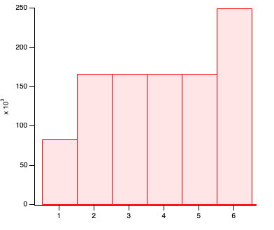

A roll of the die is floor(enoise(3) + 4), so for p(6) > 1/6, try this:
March 10, 2021 at 11:10 pm - Permalink
for p(6) = 1/4, as per your example:
March 10, 2021 at 11:48 pm - Permalink
In your example, IVP, the probabilities of the loaded dice do not add up to 100%. Is that intentional? If the probability of rolling a 6 is 3/2*1/6 I would expect the probability of rolling a 1 to be 1/2*1/6. This is assuming that the only effect of the loaded dice is to convert a given fraction of 1s into 6s.
To make that clear, I would write the code like this:
March 11, 2021 at 03:04 am - Permalink

March 11, 2021 at 03:15 am - Permalink
This is how I would handle the more generalized case. I haven't tested the histogram. You'll want to make sure to do that before you use the code.
March 11, 2021 at 04:02 am - Permalink
