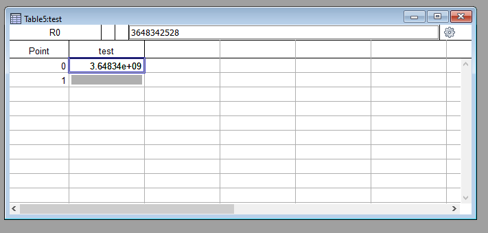

Can someone explain just what on Earth is happening here?
make/n=1 test = {3648342600}
This results in a wave with one entry, but the entry is inconsistent. Sometimes it's 3648342528. Sometimes it's 3648242688. It's completely random, and never accurate.
In the table menu, select digits and set it to a larger value. The default is to show 6 places and that is why you are getting scientific notation.

Andy, I don't think you understand. Look at the actual value getting stored in the field. It's never what I want, and this has nothing to do with scientific notation.
Even when I edit the table directly to put in the value I want, it's always off. Regardless of how many digits I display.

It is not about the table.
Each wave has a type of data it can hold. By default Make uses 32bit floating point, which is not able to hold the value you entered.
print/D test
test[0]= {3648342528}
Make/D testDP = {3648342600}
print/D testDP
testDP[0]= {3648342600}
If you use a double precision wave with 64bit floating point it can hold that value. I've created that with the /D flag. The /D flag of print tells it to print more digits.
