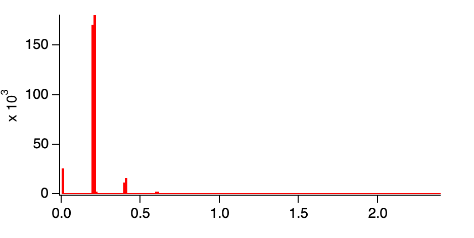

I then did a histogram of timeDiffs:
So your times are roughly 5Hz on average but not consistently close to 5Hz.

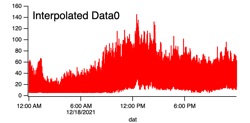

Here are graphs, also from the attached experiment, showing the original data (data0 vs timeW - I renamed your waves for simplicity):
You can see that the output data, which is sampled every 0.2 seconds, clearly differs from the input data (note the bottom around 12:00 PM). This is because your data is very noisy. Therefore sampling every 0.2 seconds will miss the positive and negative peaks. Consequently the interpolated data is not a very good representation of your input data.
Although this does achieve your goal to "interpolate them all into full strict 5Hz data", the result is likely not what you are looking for. I think this problem will affect any kind of straightforward sampling.
