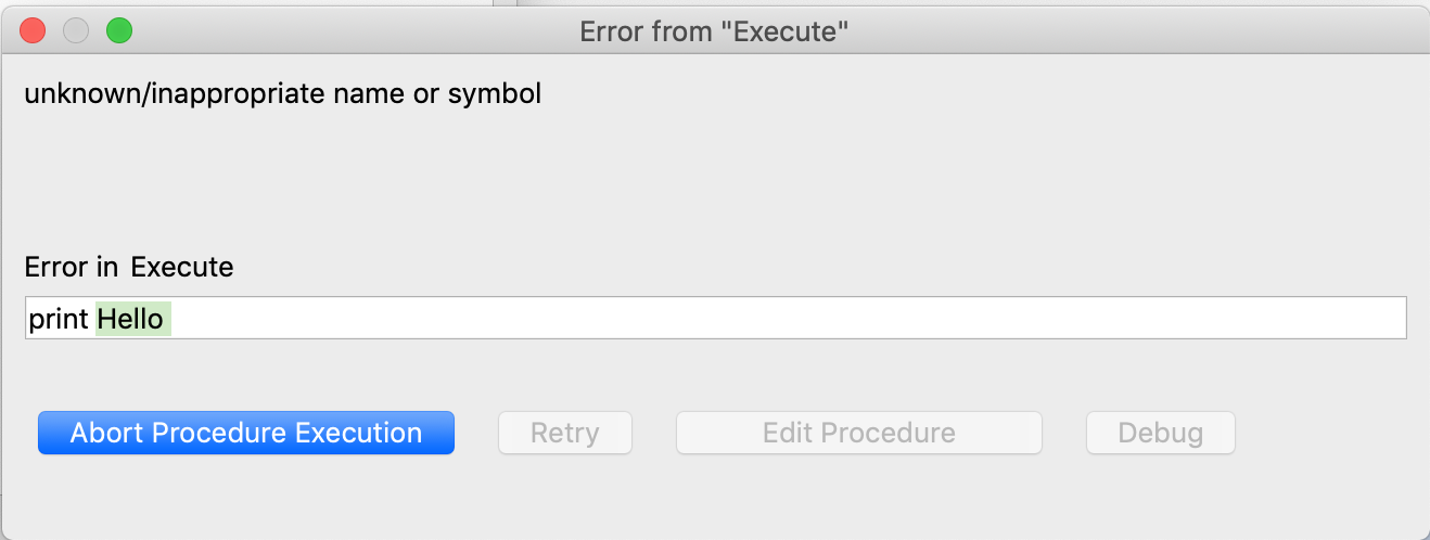

If you don't do anything else, the double quotes are interpreted by the shell. If I issue this command in terminal:
/Applications/Igors/Igor\ Pro\ 9.01\ Folder/Igor64.app/Contents/MacOS/Igor64 /X print "Hello"
Igor starts up, but I get this error:
Note that the command lacks the quotes, which were interpreted and removed by the shell.
If I use this command (note escaped quotes):
/Applications/Igors/Igor\ Pro\ 9.01\ Folder/Igor64.app/Contents/MacOS/Igor64 /X print \"Hello\"
I get what I wanted: Igor prints Hello into the history.
I could also use single quotes around the entire command string- that tells the shell that it shouldn't try to interpret anything within the command string.
