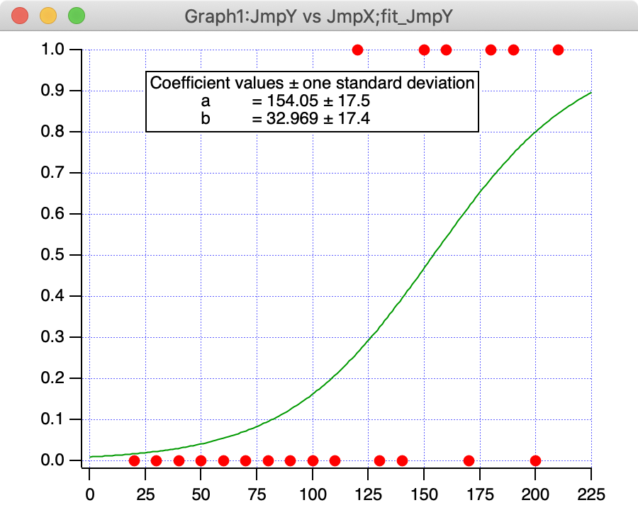

Hi All,

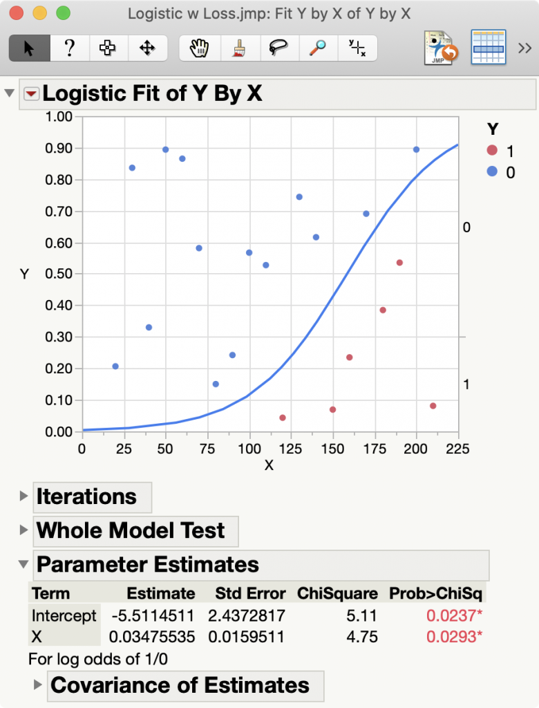

Following the lead from Steve, I created the following fit function taking advantage of the builtin stats function. To test things out I am using some sample data from JMP and I am getting a similar fit to the analysis from JMP. I just have to rationalize the difference in the fit coefficients. Note: JMP does scatter plotting of the data for visual purposes. I can replicate that later.

December 23, 2020 at 09:32 am - Permalink
Rationalized the differences in the coefficients. In JMP the exponential is -(B*x -A) and IP it is -(x-a)/b and when rearranged the match to ~10% which is reasonable for an exponential fit.
