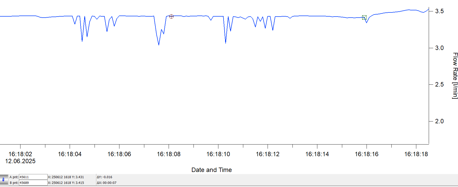

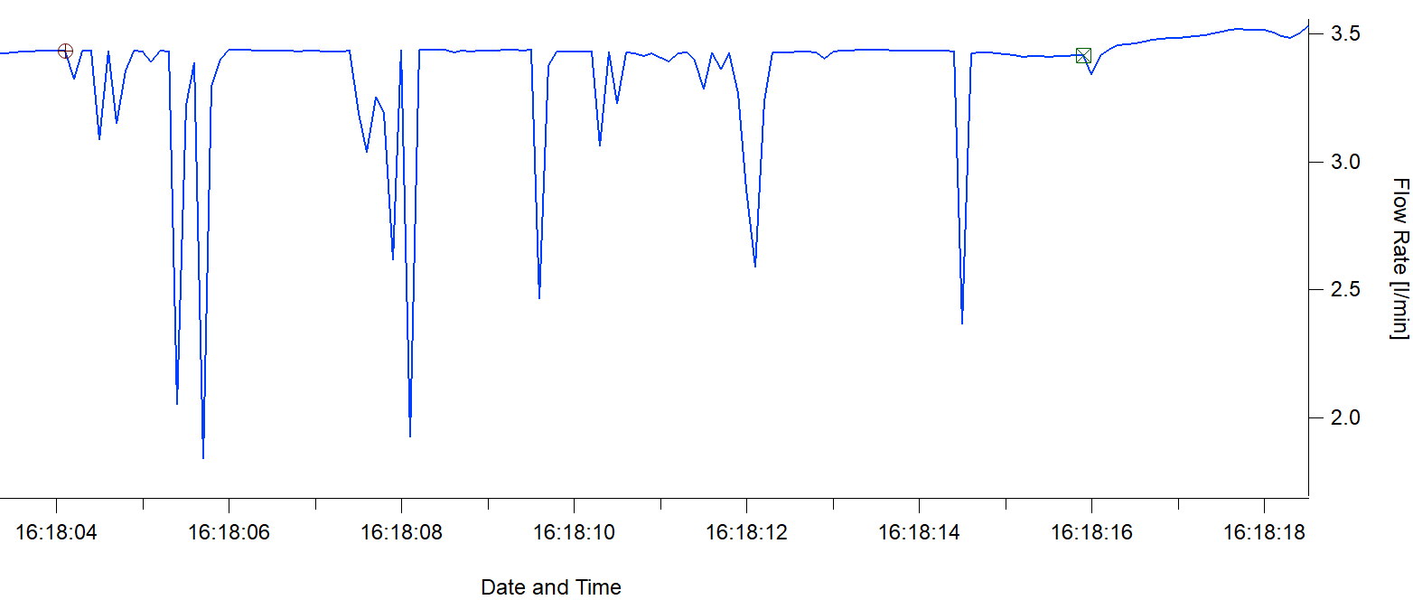

I have a wave from a measurement system which - sometimes if it is exposed to neaby high power electrical motors - creates fluctuating measurement values.
They are obvious outliers and not related to a true measured value. See attached Graph1.
I would like to do the below:
1) place my cursors at Start and End where the fluctation starts
2) replace (not delete them) the outliers (which are defined by the value < 3 in the example) by a given value; in the attached example by the value 3.431
The result should look like in "Graph2" below
I have played around with the ?: function, but was not successful, as I only could apply it to the entire wave and not to a certain part of the wave, given by the cursors.
Thanks for your help,
Marc
