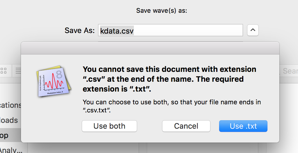

I would like to save data with the .CSV file extension for latter loading into Excel (client request - don't understand why).
If I try to save a delimited file I am forced to use .txt file extension.  The issue is Excel does not understand that .txt is a csv file and loads it as general text not columns of data.  If I change the file extension to .csv then Excel recognizes it properly.
How do I avoid the extra step of having to manually rename the file?
I don't get the "You cannot save this document" dialog on MacOS 10.13.2. Either Apple has changed something or you have a different setting somewhere. What version of MacOS are you using?
If I choose Data->Save Waves->Save Delimited Text in Igor7 or later, in MacOS 10.13.2, I can choose All Files from the file type popup in the Save File dialog and then save as <filename>.csv. On Windows I don't need to choose All Files.
If you are saving programmatically, here is an example of saving programmatically as .csv and presenting a Save File dialog to the user:

hegedus
Mac 10.13.5
If I change the popup to all files, then I can save as .csv.  Is there a way to force the save dialog to default to all files?
