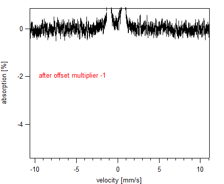

 Thank you for your reply. If I understand correctly what you are suggesting is to use the command: ModifyGraph muloffset={0,-1} . However, when I tried this, it flipped the y curve but left the labels intact. Is there something I am missing?

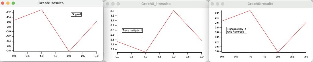

If the original wave had y values that were all negative, then the -1 multiplier would flip them to positive albeit in a mirror image.  The test data I had did show this effect and the corresponding tick labels also reflected the change in sign. Here is my example.  Note the Y axis is now showing an "unnatural" direction with increasing going down.  This retains the shape of the curve, though I would probably not reverse the axis myself.
Note: when I did the -1 multiplier the tick labels represented now positive numbers.

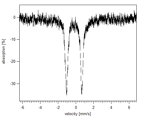

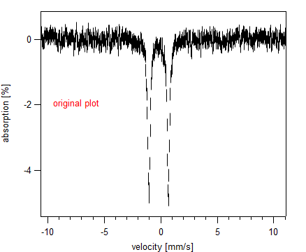

Thank you again. I am sorry, but this is not quite what I would like to achieve. Specifically, I do not want to modify the values of the original  y-wave (because that would change many other things). For example, for a figure of a typical spectrum shown below, I am simply looking for a "cheap" way to remove the minus sign of the numerical values of the y-axis labels by simply modifying the labels. I was able to reproduce your example only by multiplying the original y-wave with "-1" which changes the values of the original data (which is analogous to the procedure I described in my original post which I would like to avoid).

I did not create a new wave, just used trace offset multiplier = -1 and then reversed y axis scale. Compare my graph 1 to 3. I think it does what you want.

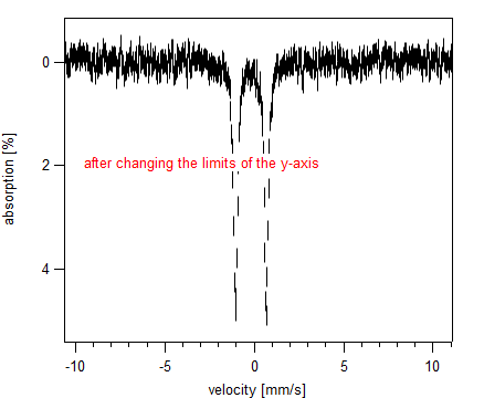

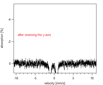

It looks like I am missing something. When I followed your instructions this is what I obtained:
It looks like at this stage, I need another step to change the limits of the y-axis by using the negative limits of the original plot's y-axis. I could get these limits using GetAxis.
Not quite what I expected but I think this should work.
Thank you!
