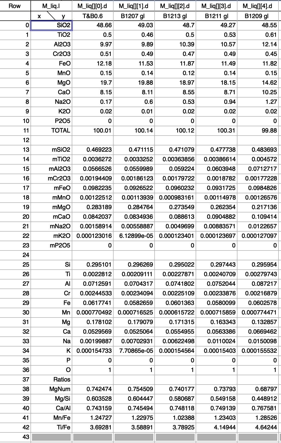

The title says it: is there a trick or hack to keep row labels visible as first table column when scrolling horizontally to the right?

sorry I wasn't precise enough: The question is about 2D waves. The attached image shows a typical example how I like to treat certain data, chemical analyses in this case. The input data is located in the first 11 rows (wt%), everything below (molar proportions, atoms etc) is then calculated. The numbers of rows can change. The wave M_liq has 110 columns and if I wanted to look at e.g. Na in column 108 or so I need to remember the row number (which is visible) or mark the row. I would be much nicer though, if the row labels could be fixed just like the row numbers (or even instead).
I sometimes use the side-by-side method, but I often move the window(s) around, so this becomes somewhat inconvenient.
Christian
March 11, 2021 at 12:31 am - Permalink

I found a suitable work-around by putting two tables (data.l, data.ld) onto a panel. This works quite well as long as vertical scrolling is not required, but in my workflow it's more likely to end up with a large number of columns (as in the example above)
