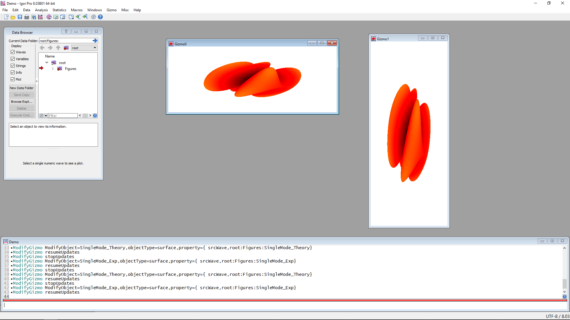

Sure, attached is an example.
In it, you will find two Gizmos opened, one vertically stretched, the other horizontally stretched.
I am finding a way to make the Gizmo windows themselves to have a 1:1 aspect ratio.
Also I should have mentioned:
I am running Igor Pro 8.0.3.1 on Windows 10, the x64 version.

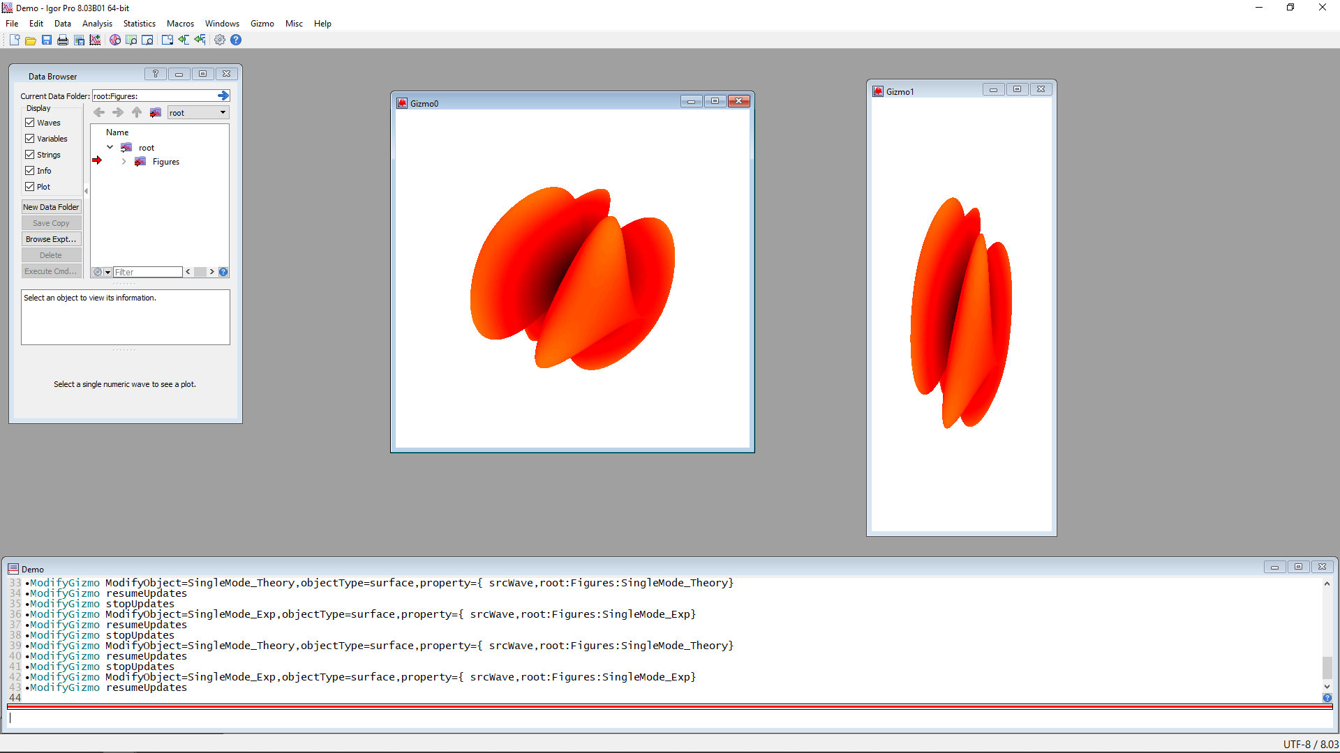

Thanks for your reply, my apology if I was confusing.
Here by 1:1 aspect ratio, I am referring to the Gizmo window itself, meaning that I wanted them to be exactly a square. The reason is that the exported graphics (PNG) will be affected by this arbitrary aspect ratio. I could do it roughly, but when I match them to a table (in illustrator), I can see they always have a bit of stretching.
Please refer to the attached image for a more accurate demo. They are not very important to be exactly 1:1, I believe a small distortion is important, but I wondered if there is a command to set them as a square more easily.
February 20, 2019 at 01:20 pm - Permalink
If it is truly the entire window that needs to be square, you can use the MoveWindow command to achieve that.
February 20, 2019 at 01:52 pm - Permalink
In reply to If it is truly the entire… by johnweeks
[quote=johnweeks]
[/quote]
Thanks, it does exactly what I wanted.
