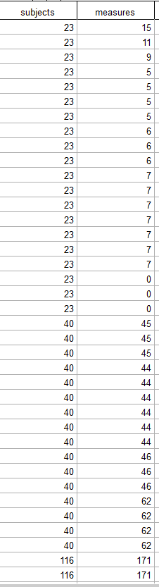

Thank you for the responses. I'm having trouble getting the code to work for all instances (some subjects contain one measure while most contain more than one. I have shared the waves with data.
August 1, 2023 at 06:44 am - Permalink

Thank you for the response, I am still working on it but it appears not to work. It's picking up subjects that don't have the 4X difference between min and max values.
August 1, 2023 at 10:28 am - Permalink
For 4x difference the equation should likely be ((V_max/V_min) > 4) not (((V_max - V_min)/V_min) > 4).
