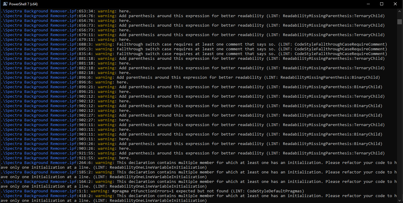

- The ReadabilityMissingParenthesis warning produces two lines of output, one of them only the word 'here'; see the attachment.
That's an interesting regression and the output should be different. I will look into it tomorrow.
This has been fixed and the newest ipt version (only available at our website) will create a correct error log.

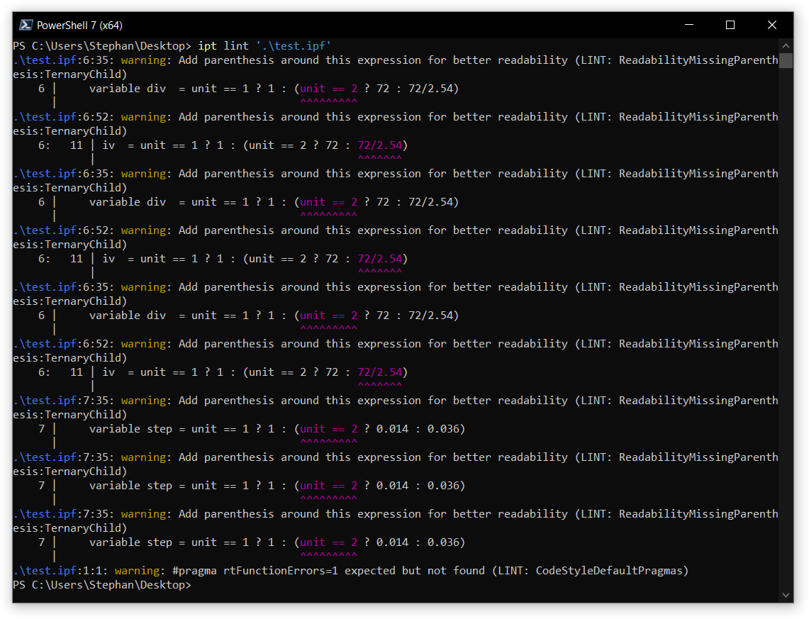

Thank you for the update. The linter seems to output identical messages multiple times in some cases. See the attached files. I also think I have seen a case where there is no line break in-between two warning outputs (i.e., the messages are directly stitched together and the alignment is all off), but I can't seem to reproduce it at the moment.
Max is already looking into that.

We are currently in the final stages before the next release, which will include a fix for the duplicate log lines that you reported.
This issue was caused by a minor bug in the rule's internal state machine, which caused the rule to match multiple times.
