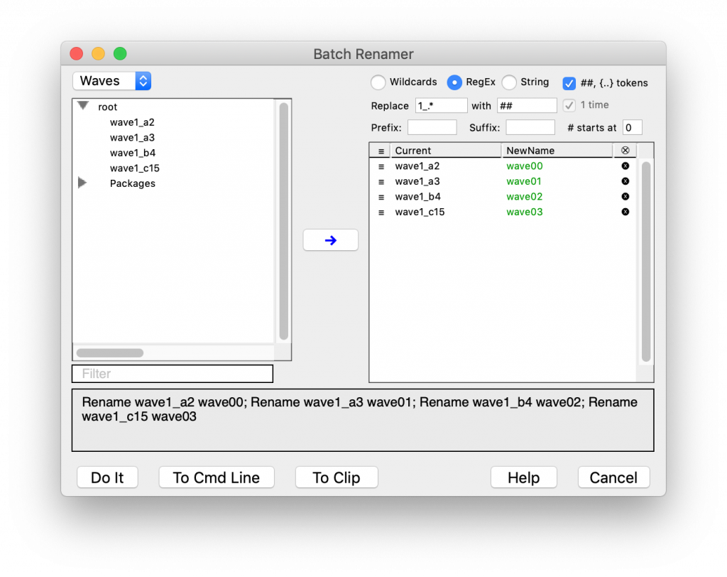

A GUI for renaming objects en masse. Looks a bit like the Rename dialog.
See also the code snippet by chozo.
When 'Wildcards' is checked, ? matches one character and * matches one or more characters. In the 'prefix', 'suffix' and 'replace with' fields, # represents a number. Use multiple # characters to set minimum number of digits. To insert a string by key from a wavenote, use the syntax {key[,keySepStr[,listSepStr[,matchCase]]]}, where the optional parameters correspond to those used in StringByKey. String parameters do not have to be quoted. DisplayHelpTopic "StringByKey" for details.
Clicking the column title for current names resorts the names alphanumerically, and you can click in the leftmost column and drag to reorder names.

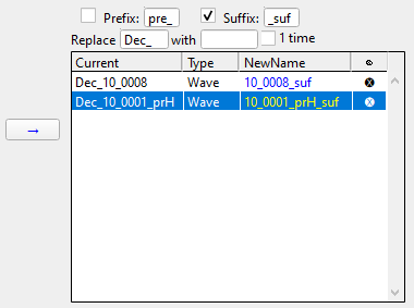

Even if cobbled together, it looks really nice already. Right, case-sensitivity is not so important in Igor, but I thought when replacing parts of names it might be useful to target the letter case to, for example, just replace the second 'd' in "Data_d20" or something. This is how the list-box looks on Win:
The colors are not super pretty (especially with the sub-pixel 'halo' around curved numbers thanks to sub-pixel dithering here on Win10), but everything is readable enough. Also you see that the Prefix and 1 time checkboxes may need a bit of alignment (the prefix controls about 10 units to the left and the time checkbox about 5 units to the right seems good).

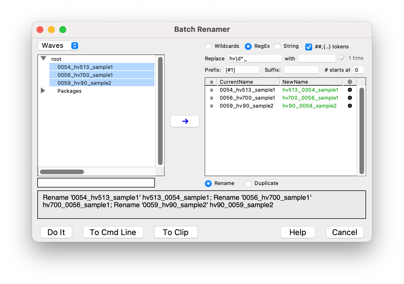

you want more options? i give you regex...
