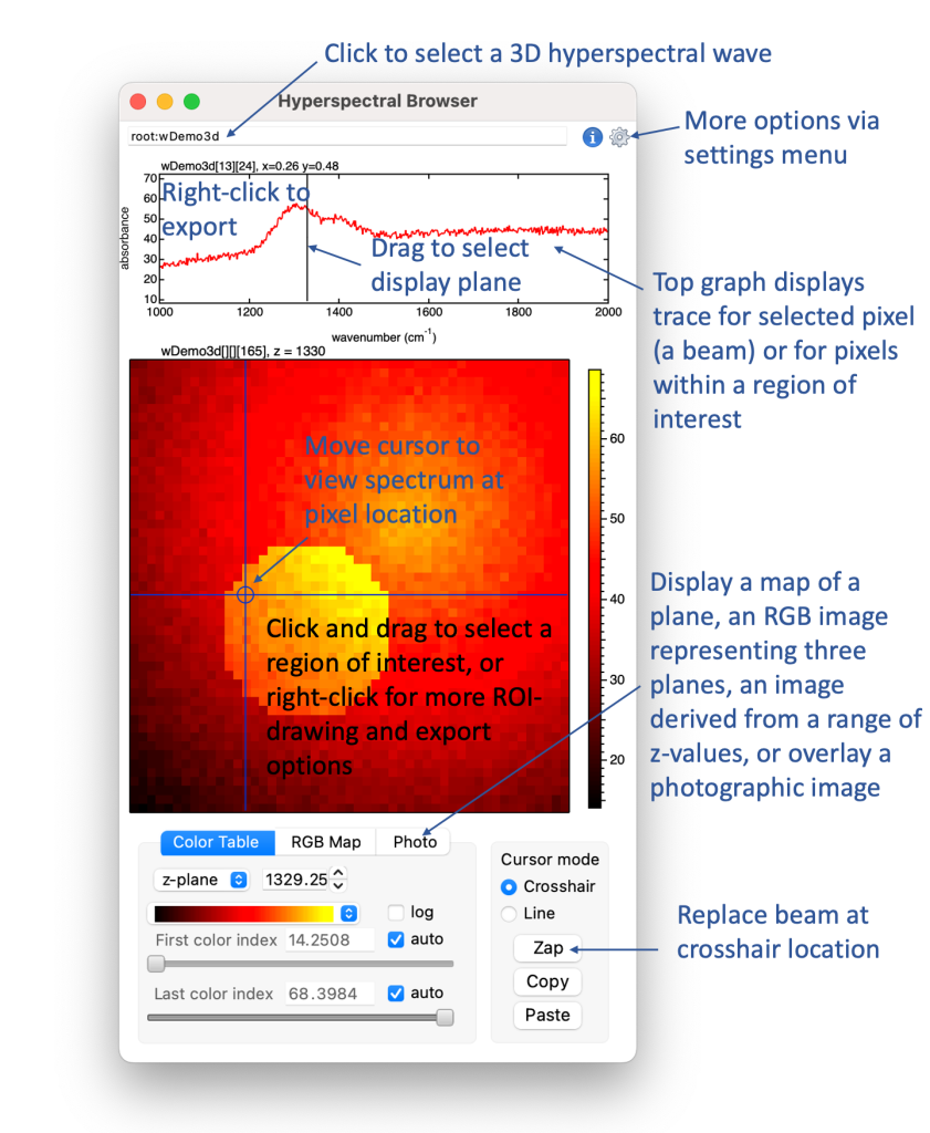

The data must be saved as a 3D wave, with x and y representing spatial coordinates and with spectroscopic or time-series data stored in the z dimension. If the data in the z-dimension are not waveform, the z values (which you will likely think of as the horizontal axis of a spectrum) should be stored in a one dimensional "z-wave". To generate a dataset for testing, execute hyperspec#demo() from the commandline.
The browser provides a user interface to efficiently view spectra (i.e., data in the z-dimension, or beams of the data matrix) at different pixel locations or to average spectra over a region of interest. Path profiles can be generated interactively for lines, segmented lines, and splines. Regions of interest can be exported, as can path profiles and 1D waves representing the z-dimension of selected image pixels. RGB maps can be constructed to map data from up to three selected planes of the datacube.
Use cmd-R/ctrl-R to resize the panel according to the aspect ratio of the map display

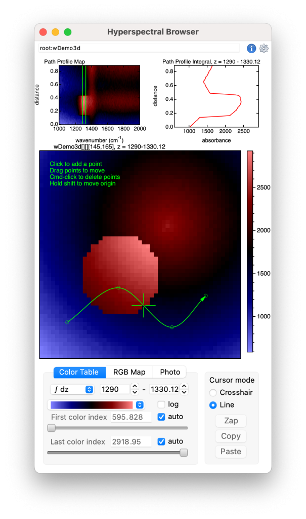

- Profiles are exported as 2D waves with columns for x and y coordinates, distance from start, and data corresponding to the current map display options
- Maps are exported as 2D data waves or 3D RGB waves
- Paths are exported as 2D waves containing x and y coordinates
- Regions of interest are exported either as 2D mask waves or as layers appended to a 3D mask wave. Lines, paths, drawing objects, manually selected pixels, and regions of interest bound by splines or polygons can all be used to create a mask.

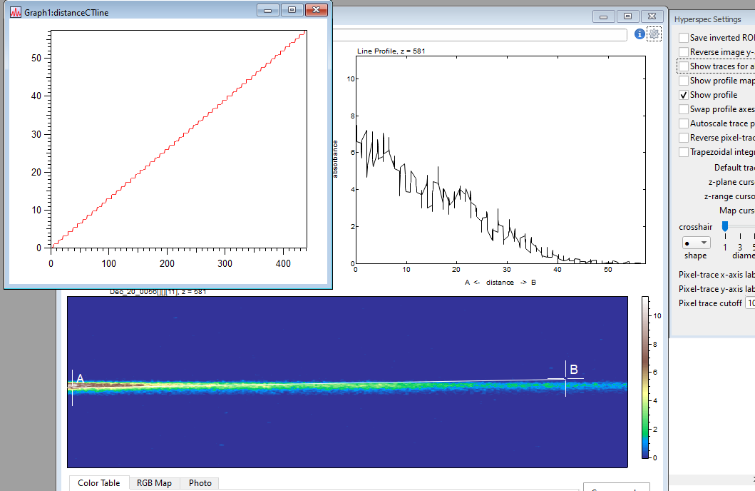

Tony, thanks. This works great. Another small thing I found: In line mode the profile gets 'spikey' when the profile line has a certain direction across my data. I found that 'distanceCTline' can have stepped structures which change in size while dragging the line across the data causing this. I don't know if this is an artifact or just a result of the large layer I am working with. See the attachment.
January 28, 2025 at 07:23 pm - Permalink
When you use the cursors to define a line, the code computes a 'Bresenham' line between the end points. The profile should then have one point for every pixel along the line, and the distances and values for the profile should match the data, unless I have made some mistake. Using the dialog to save an ROI you can see which pixels are selected on the screen, or you can export the profile to a 2D wave and investigate the coordinates and values. The distances are calculated from pixel coordinates, so they do not increase with equal step size.
If you instead draw a linear path ("Draw ROI Linear"), the profile is calculated using ImageLineProfile, which will give different results because ImageLineProfile does some interpolation.
January 28, 2025 at 11:42 pm - Permalink
FYI, if you draw a curved path, the profile is calculated using ImageLineProfile based on xy coordinates that divide the path between each node into 50 sets of coordinates. I could expose that parameter and make it user-adjustable.
January 29, 2025 at 12:00 am - Permalink
OK, thank you for the explanation. I did not look too deeply into it. This might simply be an artifact from sweeping over many pixels (>800) in one direction vs. very few in the other. Draw ROI Linear works as expected.
January 29, 2025 at 04:57 am - Permalink
If you place the mouse cursor over a spike in the profile, the corresponding pixel in the map should be marked by a cross cursor. If the map is zoomed in you may be able to tell if the spikes are real noise in the data or if something is wrong with the profile.
