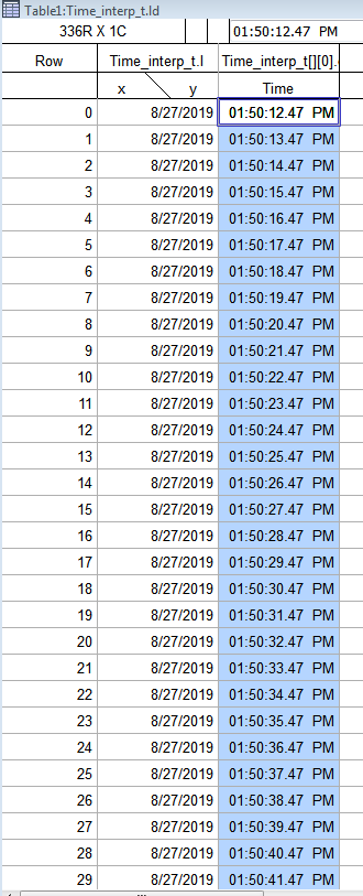

Dear all,
I have hit a snag. In my text wave, I have a time column in the PM/AM format (see attached pic). How can I convert it so that IGOR can recognize it and give me a proper time wave?
Thank you.
August 27, 2019 at 06:59 am - Permalink
This function handles time with fractional seconds and AM/PM:
// Examples:
// Print ConvertTimeWithAMPMToSecond("01:50:12.47 AM") // Prints 6612.47
// Print Secs2Time(6612.47, 3, 2) // Prints 01:50:12.47
// Print ConvertTimeWithAMPMToSecond("01:50:12.47 PM") // Prints 49812.5
// Print Secs2Time(49812.5, 3, 2) // Prints 13:50:12.50
Function ConvertTimeWithAMPMToSecond(timeStr)
String timeStr
Variable hour, minute, second
String AMPMStr
sscanf timeStr, "%2d%*[:]%2d%*[:]%g %s", hour, minute, second, AMPMStr
Variable result = hour*3600 + minute*60 + second
if (CmpStr(AMPMStr,"PM") == 0)
result += 43200 // 12*60*60
return result
August 28, 2019 at 05:15 am - Permalink
In reply to This function handles time… by hrodstein
Thank you very much. Works well.
August 29, 2019 at 03:42 am - Permalink
