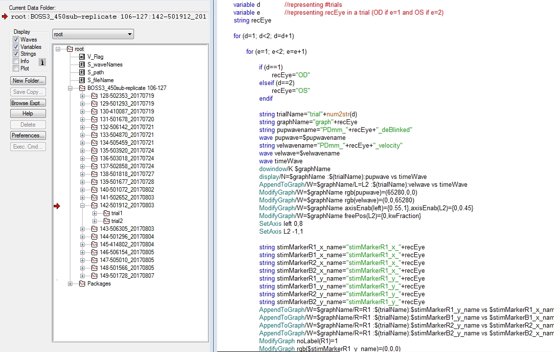

Got the following error message when running the macro "Create pupContriction layout"
"While executing Display, the following error occured: expected wave name."
The waves are already created and stored in the data folder.

Do not paste here this much code, or at least format it as Igor code. This is close to impossible to read...
This Display command makes no sense. It is impossible to define pupwave as wave reference above and then try to redirect that to specific folder location.
Wave reference ("wave pupwave=") needs to point to specific existing wave in its location (in the folder).
This looks like you took Macro code (without wave references) and changed to to function code (where wave references are required) without fixing all those references etc. This looks like you need to read Igor manual about Macros, Functions, wave references etc.

ychen344I enabled debugger but the debug window did not show up in procedure window.

ychen344This is not helpful... I eventually figured it out and got what I needed. All you needed to tell me was that "you had to use the true wave name when referring a wave in a folder."
