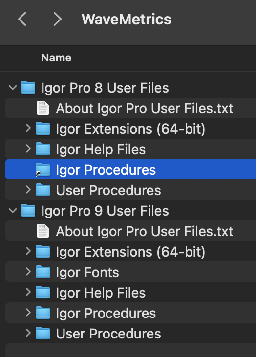

Here is my setup. The highlighted is a symlink. IP8 does not recognize the files in it. I've tried also with an alias rather than a symlink. I've looked in my System Preferences to see whether I should set something in Security & Privacy (e.g. disk or folder access).
December 20, 2022 at 05:00 pm - Permalink
I would suggest that you keep a regular folder "Igor Procedures" for both installations. Put the alias to your other Igor Procedures inside the regular folder. Or perhaps make a third folder somewhere else (in Documents or something) and put an alias to it in both Igor Procedures folders.
When Igor starts up, it looks for the standard folders; I don't know if it follows links at that time. I would have to look at our source, and that's not an area I'm super familiar with.
December 21, 2022 at 10:18 am - Permalink

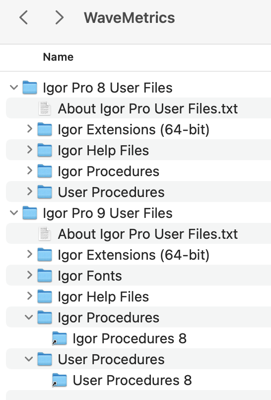

OK. Thanks. For those who need to know, this folder organization works. The aliases to the IP8 folders are inside their respective main folders for IP9.
December 21, 2022 at 10:29 am - Permalink
