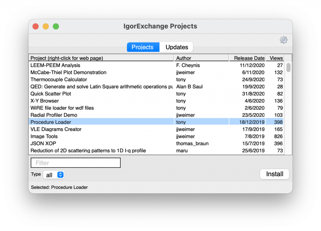

Package installer
Look for 'IgorExchange Projects' menu item in the Misc menu. The names of all of the user contributions are retrieved from wavemetrics.com. Be patient, it may take a while to parse all of the projects from the archive. If you select one of these and click 'Install' the project will be downloaded and installed in a location of your choice.
The projects list can be resorted by clicking on the column titles.

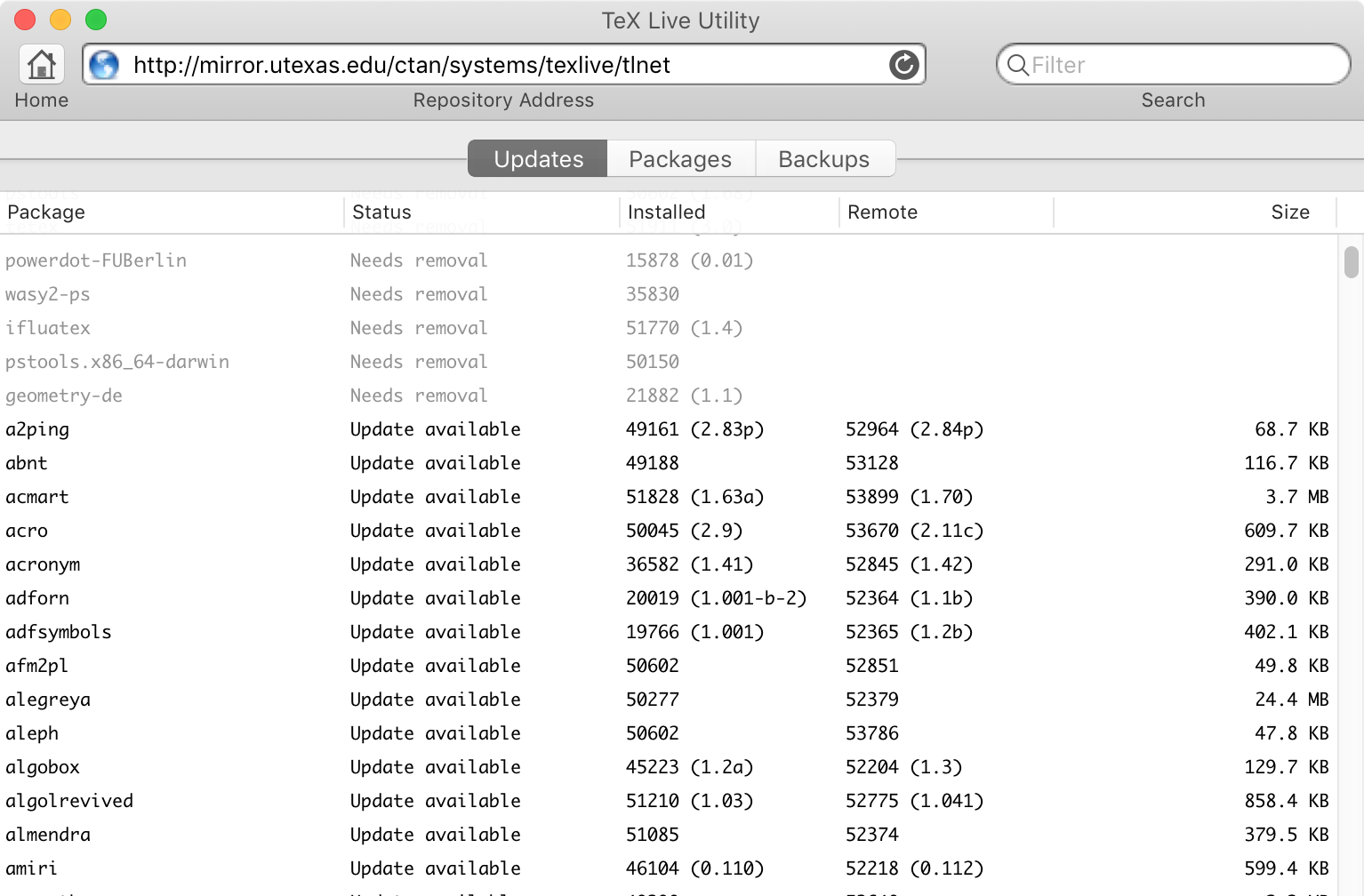

I've not looked at TeXLive, but I have seen something similar for a python IDE. Because Igor allows many different formats for packages it's hard to imagine how a general package manager could work. It would be hard to guess which files are part of which package, which require XOPs or other custom files, etc. But for simple packages that have a main procedure file that has updater headers, it may be possible to walk the user procedures folder and check for updates.
The installer does a reasonable job of installing simple packages. More complex installations are possible by means of an ITX script. But I don't think I included an option for running scripts as part of an update.
I am now thinking it would make sense to use the temporary directory provided by the OS as the download location. I'll change that for the new release, and I've replaced the 'Check for new releases' menu item with 'Check Release Versions' and 'Install New Releases'. The first prints version info to history without downloading new releases, the second checks for and downloads new releases. Is that sufficient for version checking?

Tony -- Can you offer a suggestion on this idea?
Suppose that I want users to install a specific selection of packages from Igor Exchange. I can certainly provide step-by-step instructions, starting from 1) install the Updater package (in this way), 2) go to this menu, 3) go to this tab, 4) choose this package and install, 5) choose this package and install, ...
What I imagine doing instead is creating an Igor Pro experiment. When the experiment is run, it will a) validate that required packages are installed and b) validate that installed packages are up to date.
Can this approach done by hooking into the Updater package within the installation experiment? If so, how?
Specifically, I might imagine an installation experiment that has the code below in its main procedure file.
string plist = "..." // string list of required packages
variable v_OK
v_OK = Updater#Confirm_RequiredPackages(plist)
if (!v_OK)
print "Confirmation failed. Please contact the package developer for instructions."
print "Congratulations. Your installation is ready to use!"
May 18, 2023 at 07:30 am - Permalink
Yes, that certainly is possible. There are actually a few different options.
You could try updater#install(packageList), where packagelist is a string list of project ID numbers. It used to be that you could use the short title (e.g., install("Spidergram")), but for newer projects it has to be the more cryptic project ID. This is probably the most simple way, though it may take some time to grab all the files from the web. I have to admit that I haven't used this in a long time, I hope it still works! It looks like the Install() function should return the number of successful installs.
Another option is updater#InstallFile(filePathList), where filePathList is a list of local files. This was designed for distributing packages, and can be run from an itx that you include with the projects to be installed. Or it could be run from an experiment, as you envisage.
A third option is to move all the files from a local folder to User Procedures using a script - I distribute my own package of projects like that. That way you don't need updater, and can even include updater with the other files. The projects won't be added to the install log until the next time they are updated from IgorExchange. If you're interested in this option I can send you an example.
May 18, 2023 at 09:07 am - Permalink
If I understand, the third option requires me to post a folder (ZIP archive) with updated procedure files each time they are updated. I would subsequently need to send a notice to the users to inform them that they can grab the update folder and run the update installer.
I will consider this option, especially since some of the procedures that I want to distribute may not be ones that I want posted at IgorExchange.
I should also test Updater#Install(...) option. It speaks in part to a next step ... a companion Updater#Validate(...) function. The Validate function would validate the input list of required IgorExchange packages against the current local install base, update any outdated packages as needed, and then, also as needed, install any missing packages using the Updater#Install(...) function.
I may be in touch directly via email likely in the next week or so.
Thanks!
May 18, 2023 at 10:57 am - Permalink
