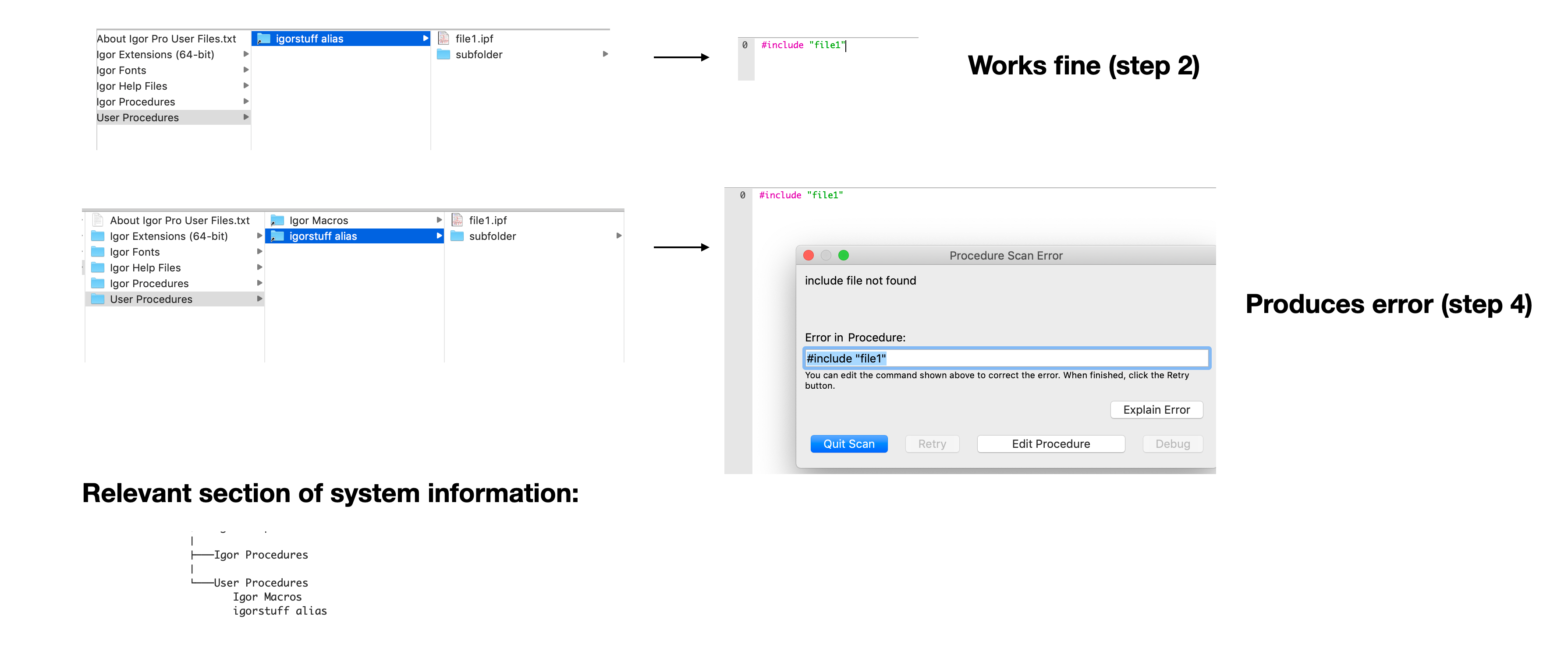

I have one big folder with lots of subfolders that contains all my Igor code, which lives in a Dropbox. I create an alias to this folder (Mac Mojave) and move said alias to the Documents/WaveMetrics/(…)/User Procedures folder. In IP6, 7 and 8, I can then #include any file in any subfolder I want. However, this workflow now seems broken in IP9 and I keep getting "Include file not found" errors.
A minimal problem I can reproduce is this:
- Create a folder somewhere that contains "file1.ipf", create an alias and move the alias to the WaveMetrics/(…)/User Procedures folder.
- Start IP9, #include "file1". File is included just fine.
- Now also move the alias to my big Dropbox folder to WaveMetrics/(…)/User Procedures folder
- Restart IP9, #include "file1" and I get an "Include file not found" error.
Stragely enough, after step 4, I can include files that are in the Dropbox folder, at the lowest level, but not in any of the subfolders. Relative paths don't seem to work either.
I'm completely stumped, not least because the same alias-to-Dropbox workflow works just fine in IP8.

From your screenshot, it looks like you know the trick of holding down the SHIFT key and selecting the Help->System Information menu item to get a full directory listing of the Igor Pro and Igor Pro User Files folders. However in your image it isn't clear if the file listing contains no children nodes under "igorstuff alias" or if you've just cropped them out.

Nope, nothing cropped out. The folder contents don't show up in the System information, whenever I alias to another folder. Including works fine though.
I'll message support with the original problem. Thanks for the help!
