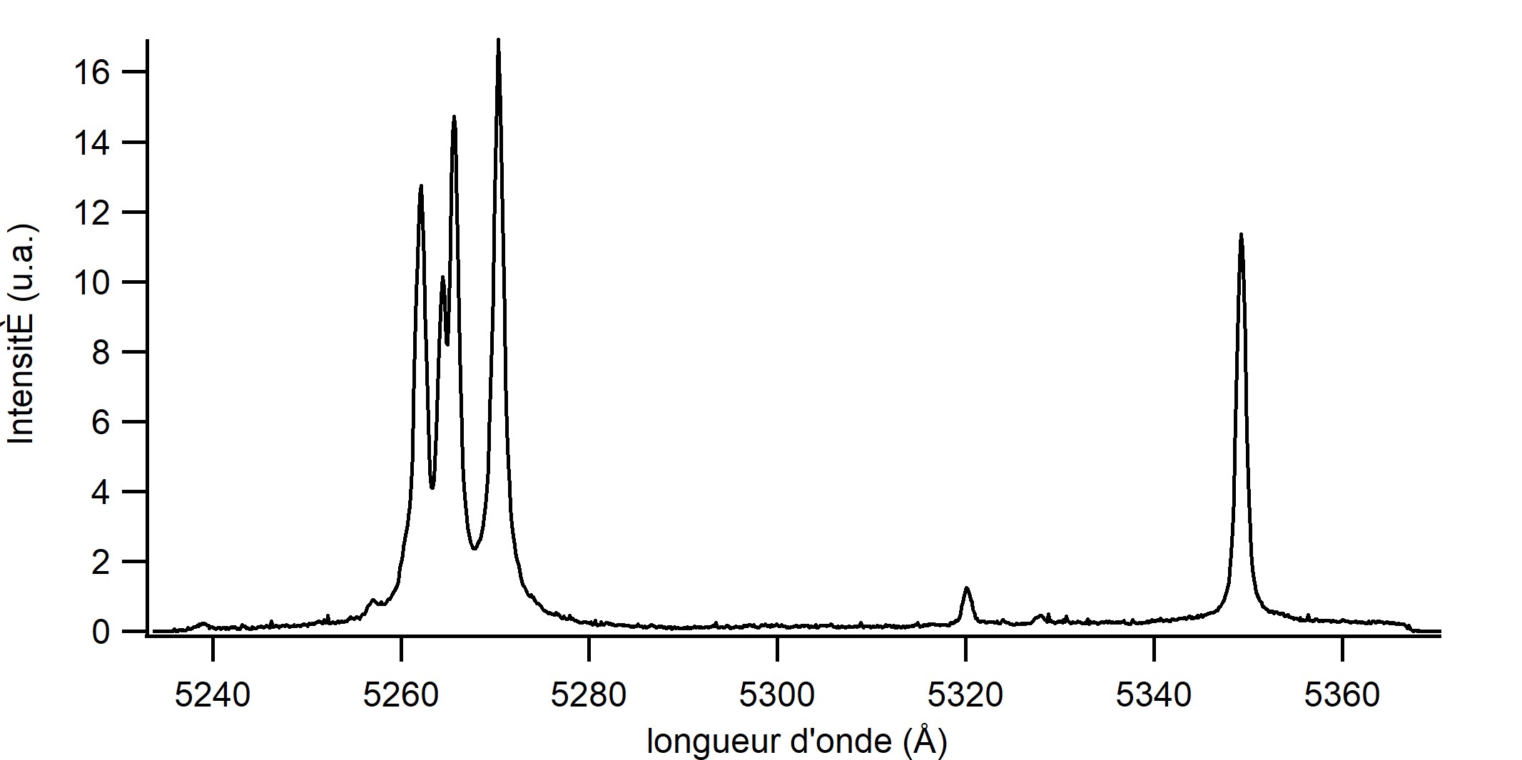

I want to normalize with the majeur element in the spectre
I guess you mean that you want to divide the spectrum by the largest value in the spectrum. You can do that with the Wave Arithmetic panel I mentioned earlier.
I use the technique LIBS atomic spectroscopy. I would like to normalize to a reference value like this divide Intensity/Intensity(element reference),Intensity(element reference) mean high intensity in the spectre
If you would like to all spectre by the maximum intensity you use these scipt

I don't understand. I would like to normalize my spectre. I want to normalize with the majeur element in the spectre
