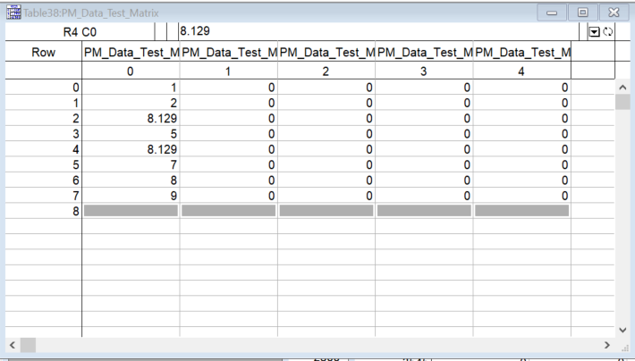

Hello. I m stuck on an issue that seems trivial, but somehow I must be missing some simple mistake. I want to make a function that takes a 2D wave and a specific value as input and deletes all rows of the 2D wave that contain this value in the first column.
For example take the test matrix below:
I want to remove the rows containing 8.129 in the first column, so rows 2 and 4. So I have written a function:

When I run RemoveRowsContainingValue(PM_Data_Test_Matrix, 8.129) though, it does not remove the rows. What is it I'm missing here?
