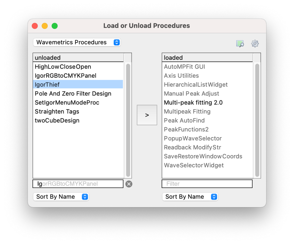

A utility to load or unload procedure files from the User Procedures or Wavemetrics Procedures folders.
Adds a "Load or Unload..." item to the File menu and, rather presumptuously, takes over the cmd-1/ctrl-1 shortcut.
Unless you are a developer, you can skip to the last section.

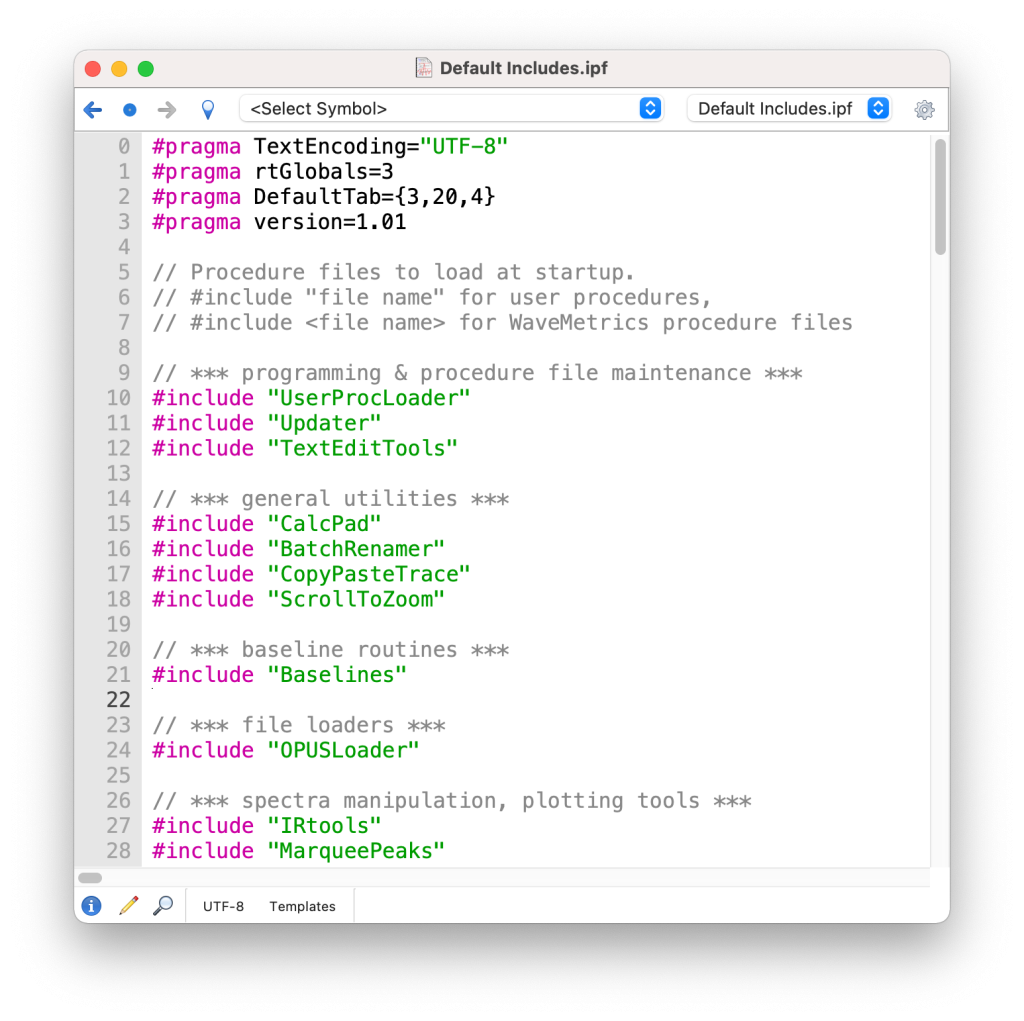

It makes sense for this procedure to be loaded at startup, so a good place to store it is in the Igor Procedures folder (see Help > Show Igor Pro User Files). If you use the IgorExchange installer to install the procedure loader it will by default be installed in the Igor Procedures folder.
Personally, I keep only one procedure file in the Igor Procedures folder: a file that has the sole purpose of including my personal selection of user procedures and Wavemetrics procedures at startup. It looks like this:
