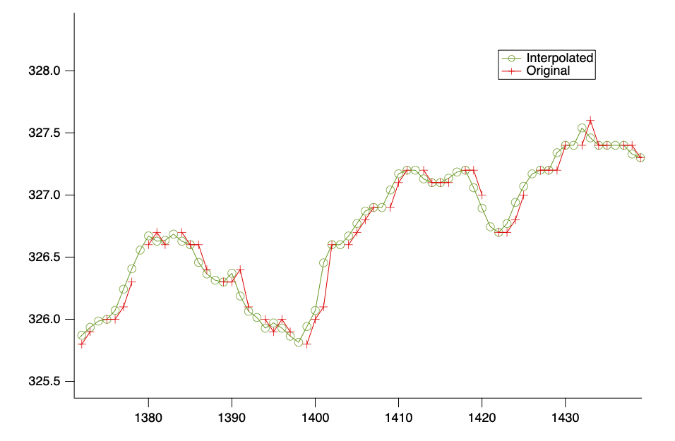

The Interpolate function can do this for you. Go to Analysis => Interpolate. Then set the Destination Points to the same size as your input. NaNs will then be replaced with the average.
