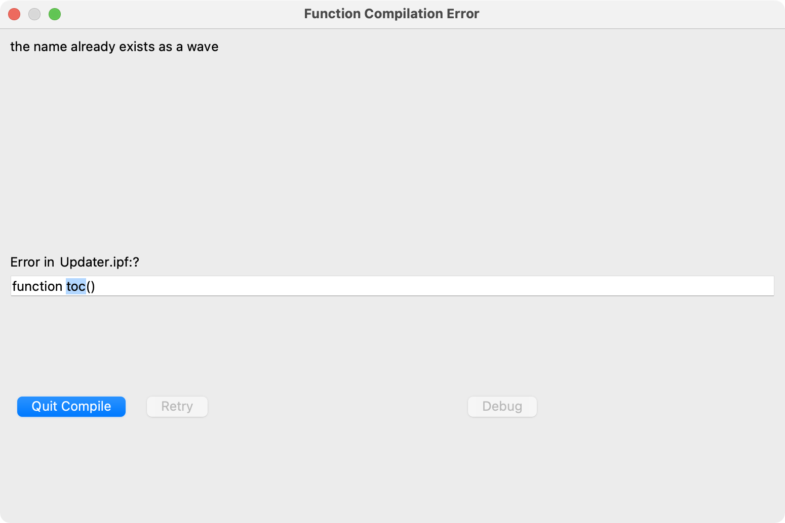

Just FYI. Version 5.11 has two functions tic and toc to start and start an MSTimer. They are not called from anywhere in the routines as far as I can tell. The toc function in particular threw an error when I opened an experiment that had a wave named ToC (temperature in oC).
tony
Are you sure that it is this function that causes the error? This is an independent module that should have its own namespace. I just created a wave named ToC without problem. Maybe you have another procedure with a function toc()? Maybe even one of mine that's not an IM?
jjweimer
I cannot get the error to repeat itself. It is however flagging the Updater package. I will explore further and contact you off-line when I learn more. Thanks.
