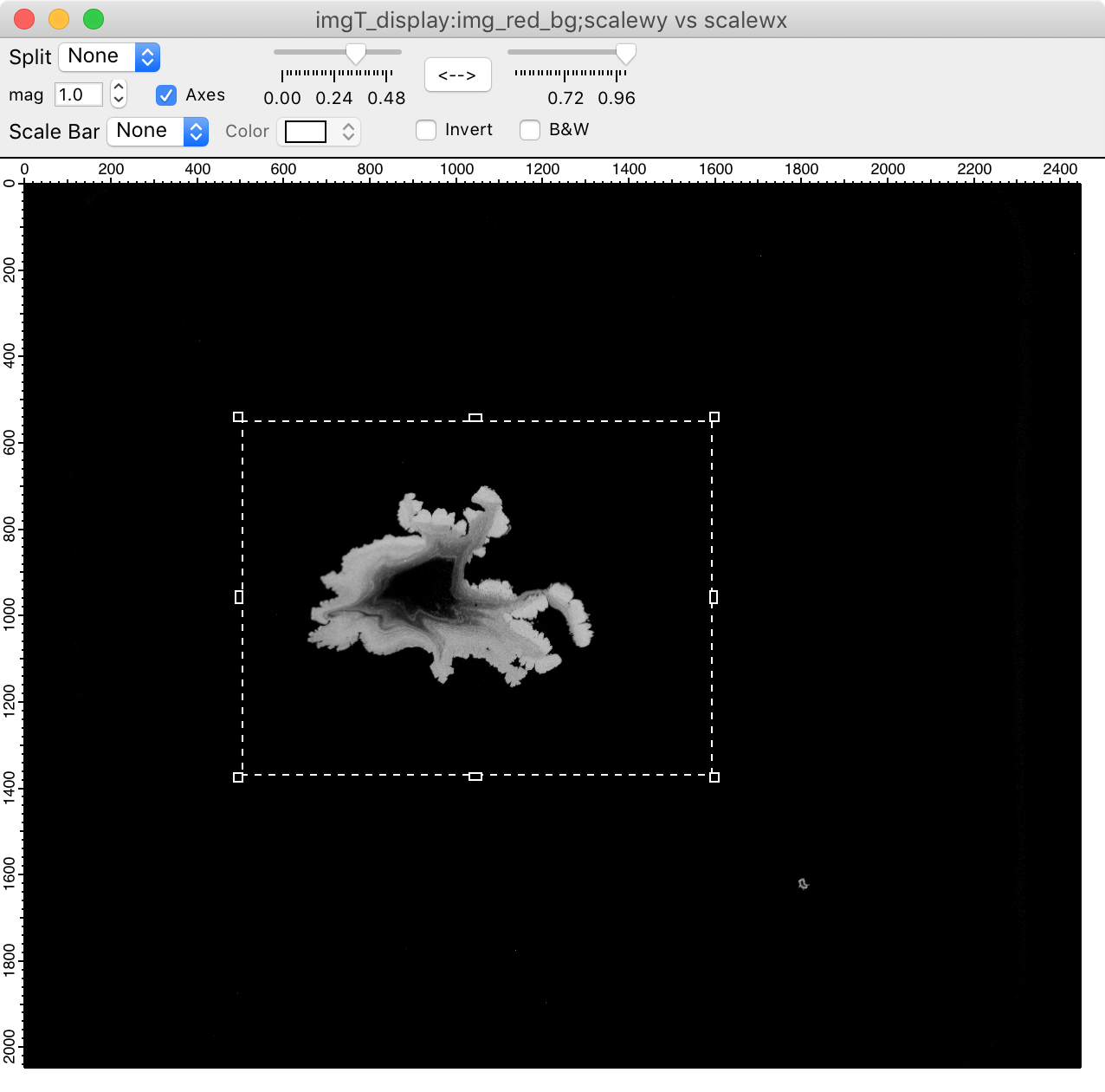

I request a window hook function return variable:
26        "marqueeaction"    a marquee has been added, removed, or moved in position
This will remove the need to set and track global variables. My specific need is to track the movement of a marquee and keep users from extending it beyond the bounds of an image window.
jjweimer
The marquee is being drawn within an image to set an RoI. I'm not clear how cross hair cursors will be easier or even doable to achieve what I need?
In the meantime, I have a window hook function that, on a mouse-up event, does a cross-check to reset the marquee when it has been dragged outside the image bounding. It works. It would just seem more effective/cleaner to only have to grab the specific event code I need.

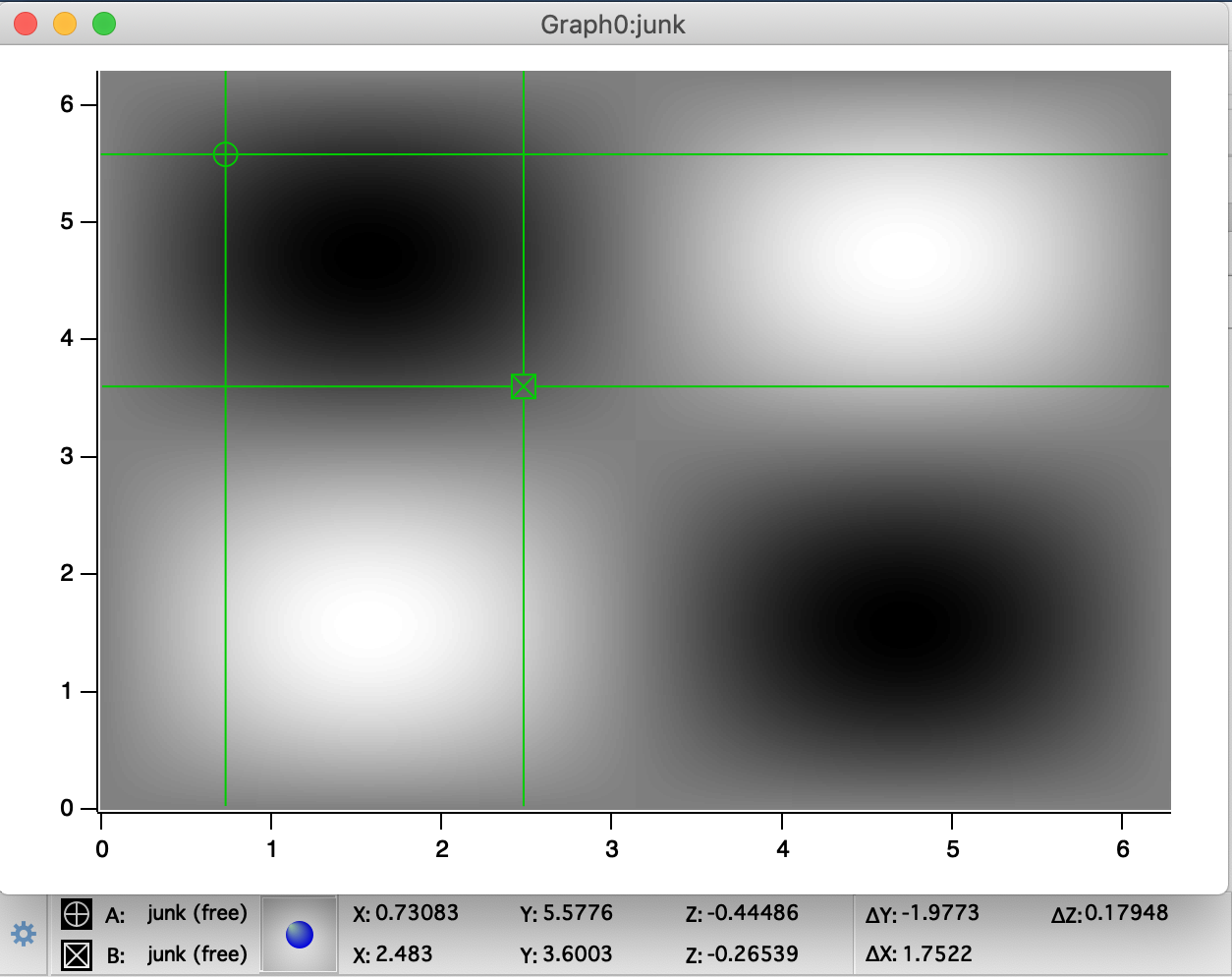

Cross-hair cursors are just normal graph cursors but instead of just the circle or square icon, they have lines that extend across the plot area. With a combination of two cursors (you can even use cursors beyond the standard A and B so that you won't use up the most-used cursors) you can enclose a box on the graph, just like using a marquee. Further, you can make them free cursors so that they don't stick to specific data points in your image.
I've attached a screen shot of an image with cross-hair cursors.
One advantage is that a window hook gets notified when they move.
One possible disadvantage is that you might need to write some tricky code to create a mode where they move together, though if they are both selected the arrow keys will do that. I think you might still need your cross-check code if the cursors are on a zoomed-in graph.
There are lots of things you can do to change the appearance/behavior of graph cursors.
