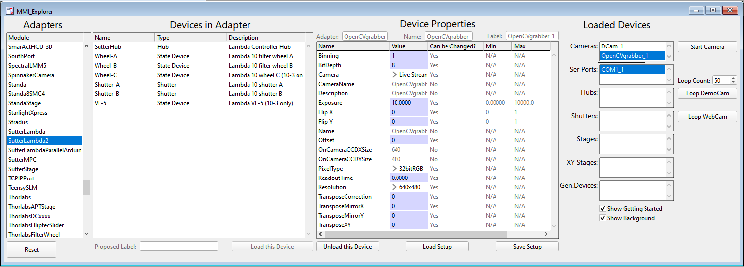

MMI Explorer
The MMI Explorer is a control panel that lets you navigate the tools and options provided by MMI and the hardware connected to your computer. You can find this panel under File Menu->Example Experiments->Imaging->MMI Demo.

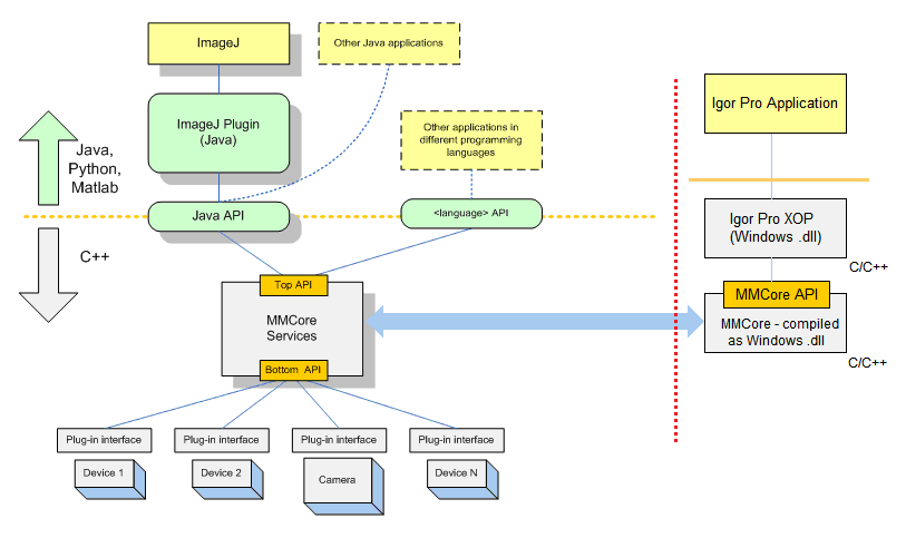

MMI Architecture
Interface between Igor Pro® and Micro-Manager.
The modules shown to the left of the red dotted line make up Micro-Manager’s normal software architecture. The MMI interface to Igor Pro is composed of the modules shown to the right of the red dotted line. (Diagram adapted from https://micro-manager.org/media/Block_diagram.gif.)
