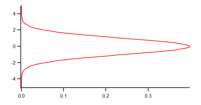

The way I'm reading your question, display ywave vs xwave and ModifyGraph mode=0 will give a line through your xy coords. So, I guess you mean something else? What do you want to do with the index wave?
I am not sure if this is what you want, but there is the `swapXY = 1` option in `ModifyGraph`:
s=0: Normal orientation of X and Y coordinates.
s=1: Swap X and Y values to plot Y coordinates versus the horizontal axes and X coordinates versus the vertical axes. The effect is similar to mirroring the graph about the lower-left to upper-right diagonal.
This will allow you to have only yWave plotted with lines between points and not having to create a separate x wave.
Note that this option is global for all elements in the current graph, so if you want to add another axis with "normal" behavior, you need to put this into a sub-window.
ukos wrote: Note that this option is global for all elements in the current graph, so if you want to add another axis with "normal" behavior, you need to put this into a sub-window.
Note that you can do Display/VERT or AppendToGraph/VERT to get the effect of SwapXY applied to a single trace. I can't tell if this actually solves the OP's problem, though.
December 4, 2018 at 12:39 am - Permalink
December 14, 2018 at 09:01 am - Permalink
In reply to Make yWave SetScale/I x, -5,… by ukos
johnweeksNote that you can do Display/VERT or AppendToGraph/VERT to get the effect of SwapXY applied to a single trace. I can't tell if this actually solves the OP's problem, though.
December 14, 2018 at 10:34 am - Permalink
