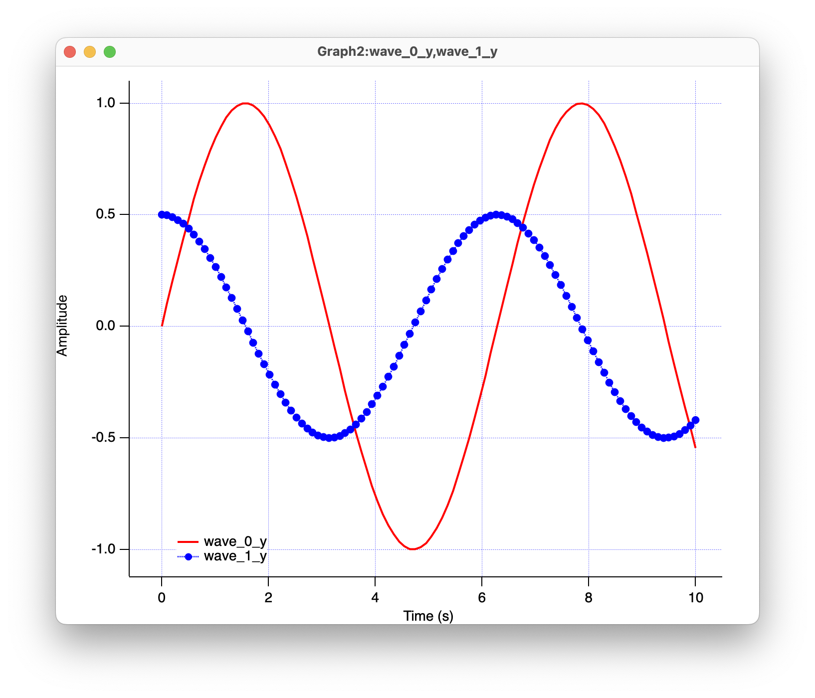

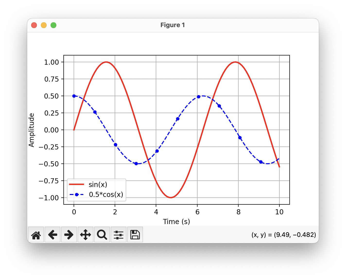

Here's an example, coded with Claude:
    # Create a sample matplotlib plot
    x = np.linspace(0, 10, 100)
    y1 = np.sin(x)
    y2 = np.cos(x) * 0.5
    fig, ax = plt.subplots(figsize=(6, 4))
    ax.plot(x, y1, 'r-', linewidth=2, label='sin(x)')
    ax.plot(x, y2, 'b--', marker='o', markersize=4,
            markevery=10, label='0.5*cos(x)')
    ax.set_xlabel('Time (s)')
    ax.set_ylabel('Amplitude')
    ax.grid(True)
    ax.legend()
    # Convert to Igor Pro format
    matplotlib_to_igor_itx(fig, 'example_output.itx', 'ExampleGraph')
Python plot (454.37 KB) Converted igor pro graph (453.42 KB)
That's an interesting idea, and probably doable for simpler graphs. I imagine you could at least get 'close enough' to the matplotlib graph as a starting point for making further modifications in Igor. As a potential alternative to saving Igor commands in an .itx file, you could also generate the graph directly from Python by taking advantage of the `igorpro.execute()` method, which allows you to execute any arbitrary Igor code. Here's a first pass at converting the graph you provided into a graph in Igor. Some things like the grid lines and legend are missing, but you get gist. You pass the 'fig' object in to the 'convert()' method after your code is finished running:

For developing this, I created a public git repository that I'll be 'casually' working on (benmurphybaum/IgorPlot: Converting matplotlib plots into Igor graphs using Python). Feel free to clone it and submit pull requests for any code you (or anyone else) wants to add. There are some instructions on setting up the project in the readme. I have also included some Igor code that will automate creating a virtual environment for the project and installing the dependencies -- I'd recommend starting there.
As of today, it will convert simple line plots reasonably well, but other graph types are not implemented yet. Once the graph is converted and displayed in Igor, you can create a graph recreation macro to save the Igor commands that will regenerate the graph.
DoWindow/R NameOfGraph
The code that will regenerate the graph is saved into the main procedure file in Igor. This is going to be one of your best resources for your students to use to get a feel for the Igor commands needed to customize graphs.
