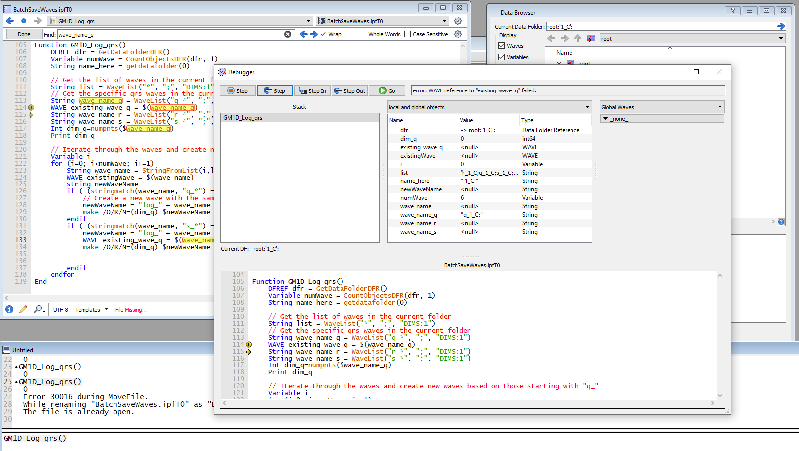

Thank you for your correction. I tried this code and compily works well. But it cannot work properly. As screenshot shown, Wave existing_wave_q is null. I have no clue how to fix this issue. So what others I can do?
error message:
While executing WAVE, the following error occurred: WAVE reference to "existing_wave_q" failed.
String wave_name_q = WaveList("q_*", ";", "DIMS:1")
WaveList returns a semicolon-delimited list of waves. In your screenshot example, it has found one wave, q_1_C.
Use StringFromList to extract a string from a list.
wave_name_q = StringFromList(0, wave_name_q) // set wave_name_q to first string in list
WAVE existing_wave_q = $(wave_name_q)
For your code to work reliably you must ensure that the required wave is the first wave that Wavelist finds.
