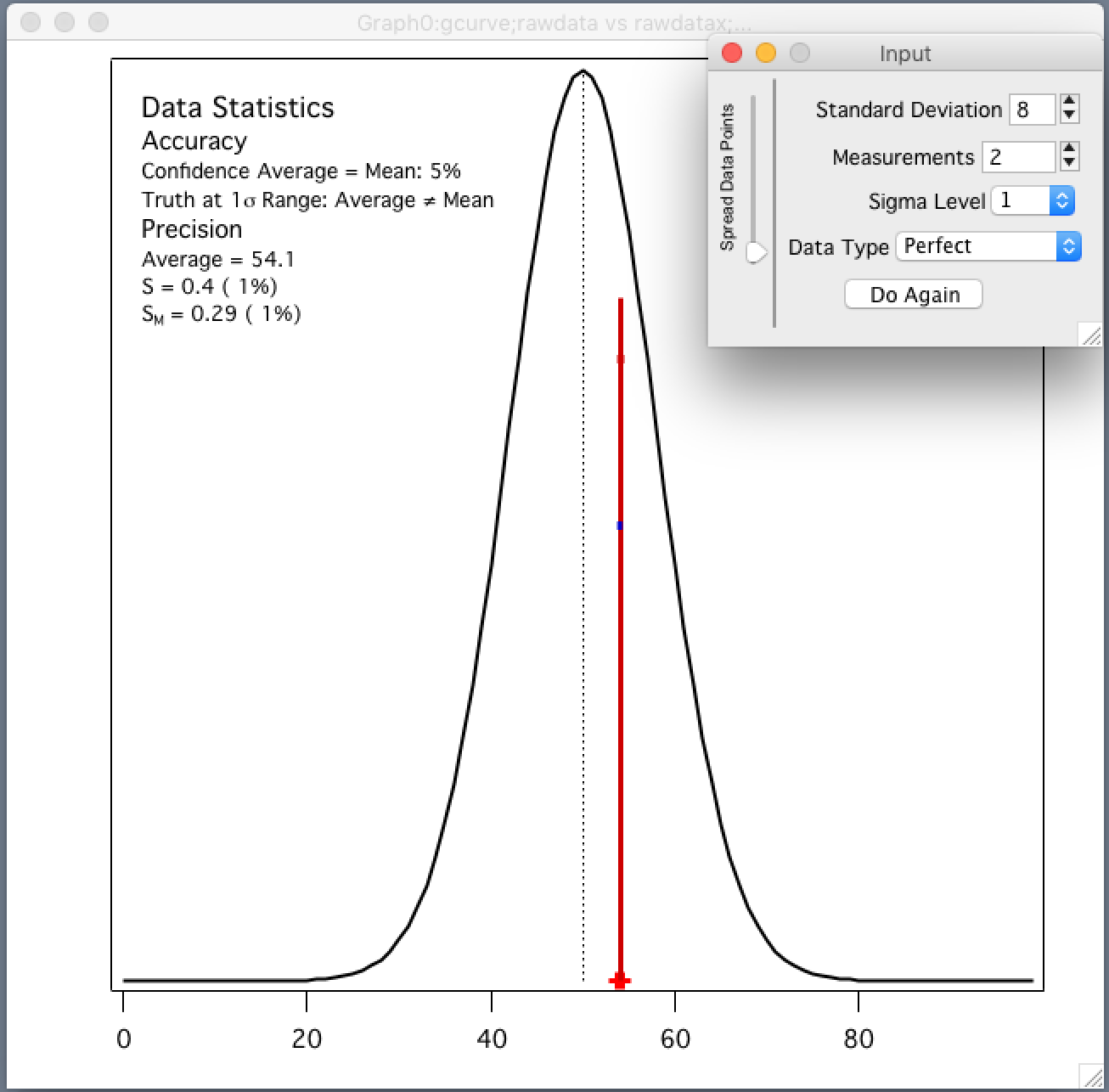

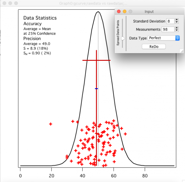

Thanks. I am heading that way. My latest iteration shows as in this figure.
I hope to post the demo here soon. Including a way to "build the stats in steps" may have to be something I do as a summer project.
February 26, 2016 at 11:55 am - Permalink
I hope folks in education might find this tool can help them explain the concepts of precision and accuracy to students. Indeed, the driving force for me to make it was a realization that students in undergraduate chemistry labs seemed to have no clue what the concepts really mean. Even I learned some important things by the time I was done.
