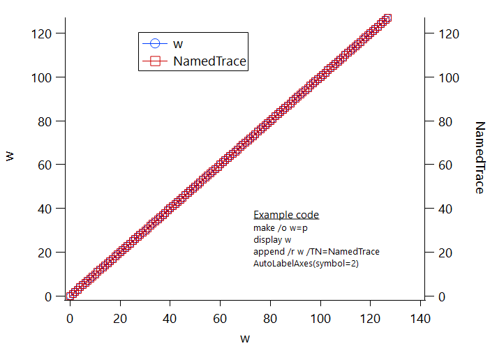

Automatically label axes according to the plotted waves or trace names
Run autoLabelAxes(symbol=2) to label all axes by their trace names.

//  autoLabelAxes()  // axes labelled with "\c" (wave name)
//  autoLabelAxes(symbol=1)  // axes labelled with "symbol and trace name" (like Legend)
//  autoLabelAxes(symbol=2)  // axes labelled with "trace name" (like Legend but no symbol)
