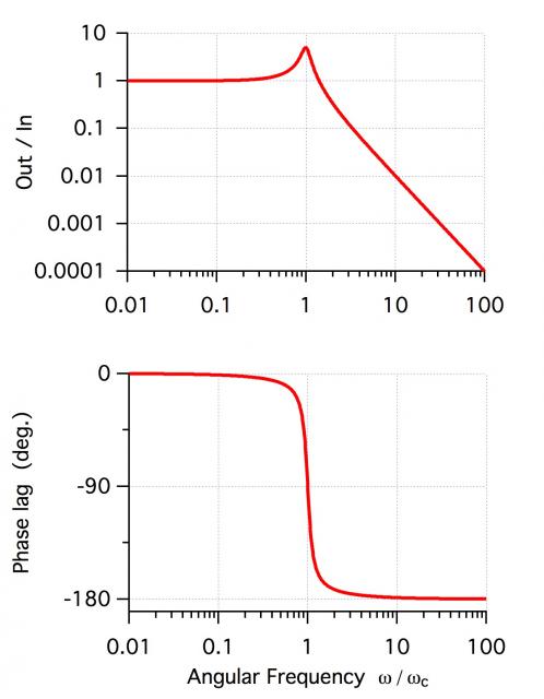

This gives a one-line function call that will create waves for the magnitude and phase response of a transfer function for N evenly spaced (in log) points between angular frequencies omega_1 and omega_2. One slightly non-standard feature is the use of amplitude ratios rather than dB for the magnitude plot. I think the latter units should be retired. For those who don't, converting is easy.

Make /o/d/n=1 pw={0.1}               // create a parameter wave; set the damping to zeta=0.1
•Bode(SecondOrder,pw,0.01,100,1000,"order2")Display order2_mag vs order2_omega                       // these are the minimal graphics commandsModifyGraph log=1                                        // the attached layout has been "prettied up" in inessential waysDisplay order2_ph vs order2_omega
•ModifyGraph log(bottom)=1
